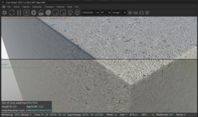

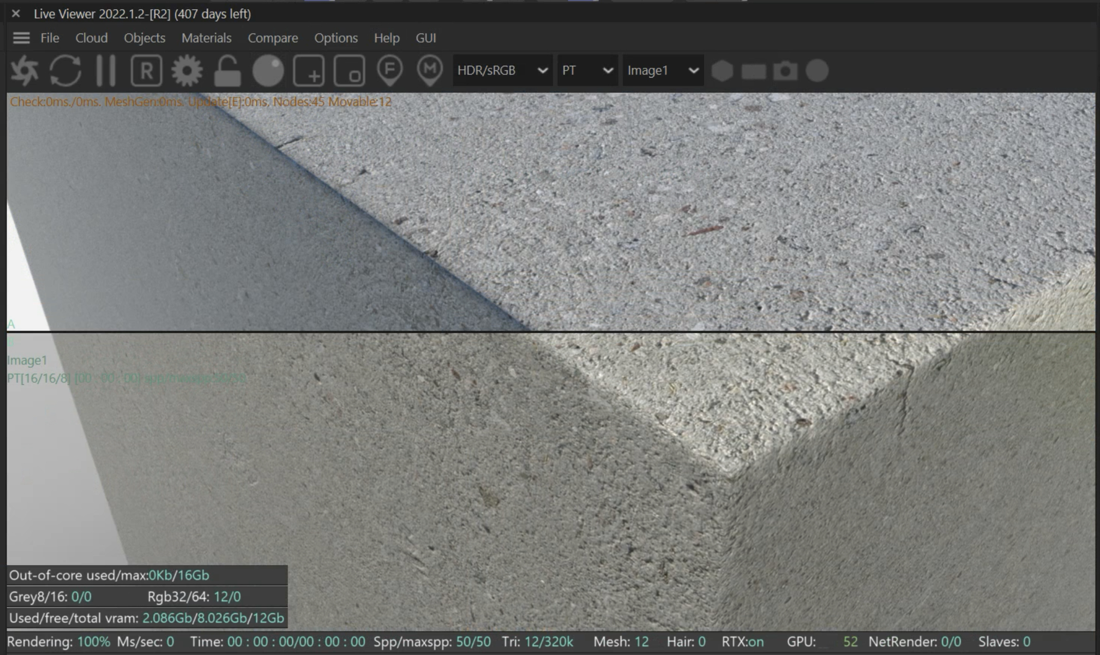

Finally, please consider that the Rounding Edges effect depends form the hardness of the light.. on top with Sun Light, at the bottom with HDRI lighting:

thanks for the helpful suggestions. so the rounded edges effect basically doesn't work with the way hard shadows are rendered?
I was kind of under the impression that this did work before (I'm mainly doing arch viz with octane).
but maybe I'm mistaken...

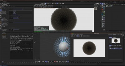

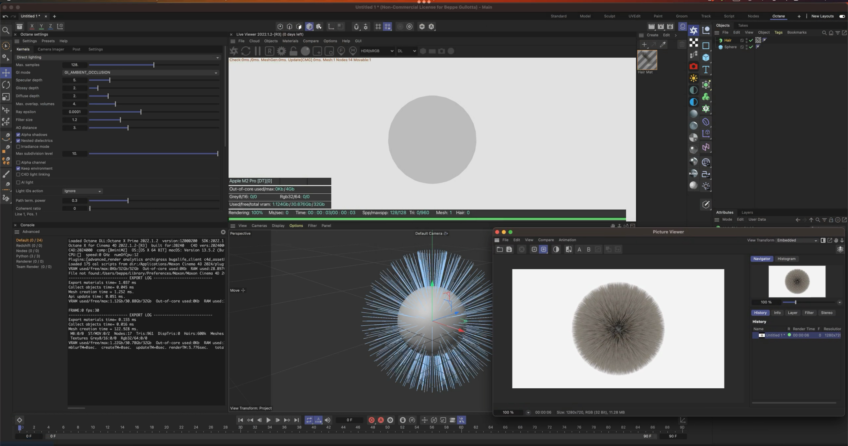

I tried 2022.1.2_R3 on MacBook Pro M1 Max & macOS Ventura & C4D 2024 and hair doesn't seem to be working.

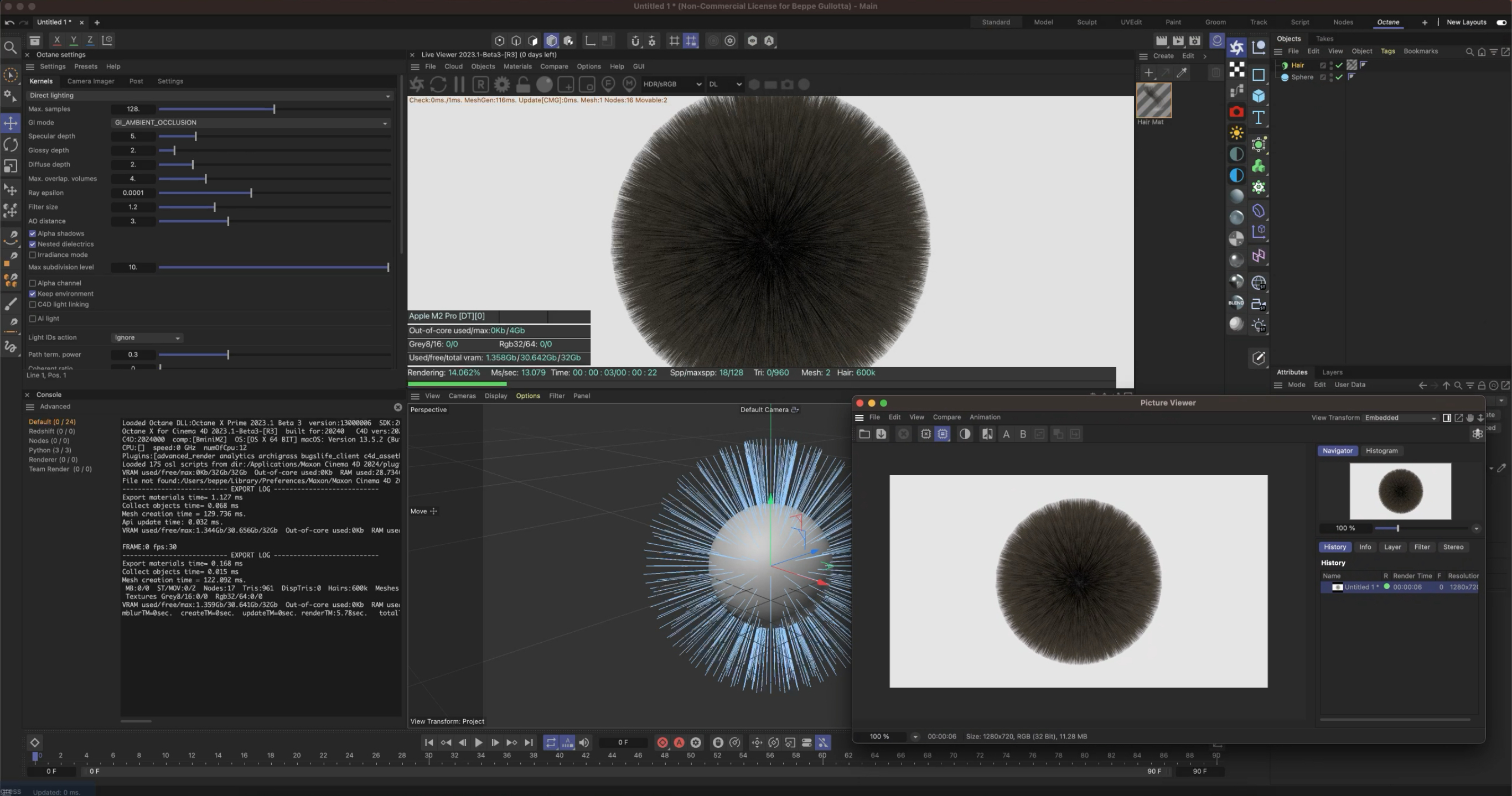

Hi, yes, it is a know issue of new C4D 2024, Hair object is not visible in Live View, but correctly rendered in Picture Viewer:
The issue has been already fixed in 2023.1-Beta3-R3 version, the stable version will be fixed at next update:
Please, use the following version in the meantime:
https://render.otoy.com/customerdownloa ... R3_OSX.zip
