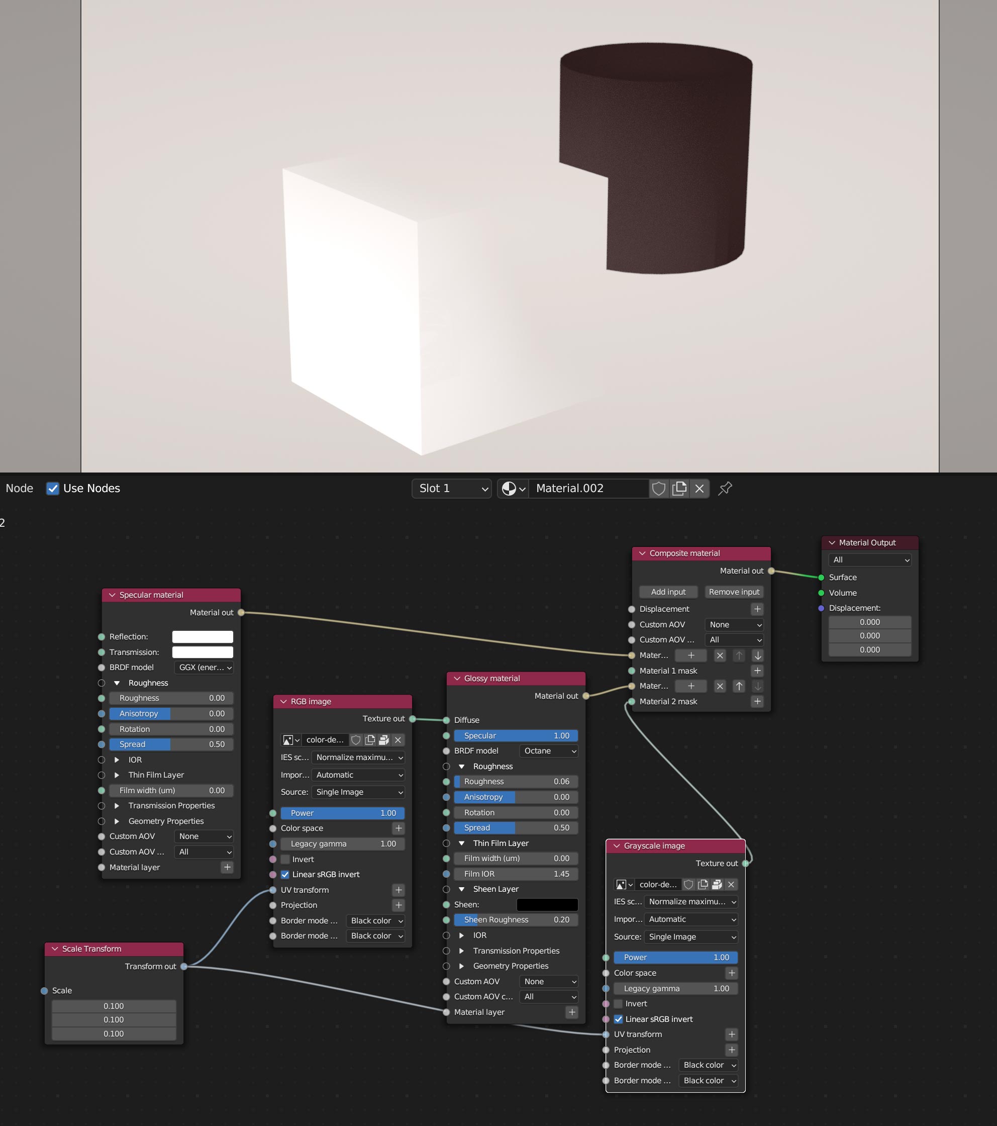

Here is my attempt for Composite material between a Specular and a Glossy:
CompositeSpecularDecal.blend.zip
(116.21 KiB) Downloaded 801 times
Note that I have used an UV Transform Scale node for the decal mask, better to use a full Transform node to move the decal where you want.

Hi Beppe, thanks for the test! I also achieved that composite material, maybe I mis-explained; after masking the specular with another material with its PNG+A mask, I wanted to put on the top, the a PNG+A with the original image, let's say a logo with colors (on that glossy material).
So not just a mask but adding an image on this PNG.
Maybe I am just over complicating :)
Posts: 10549
the Glossy has a red RGB Spectrum node, just assign the decal color texture and it should work, but you need to connect the UV Transform node of the mask to the color texture, to have the same scale and position.
ciao,
Beppe

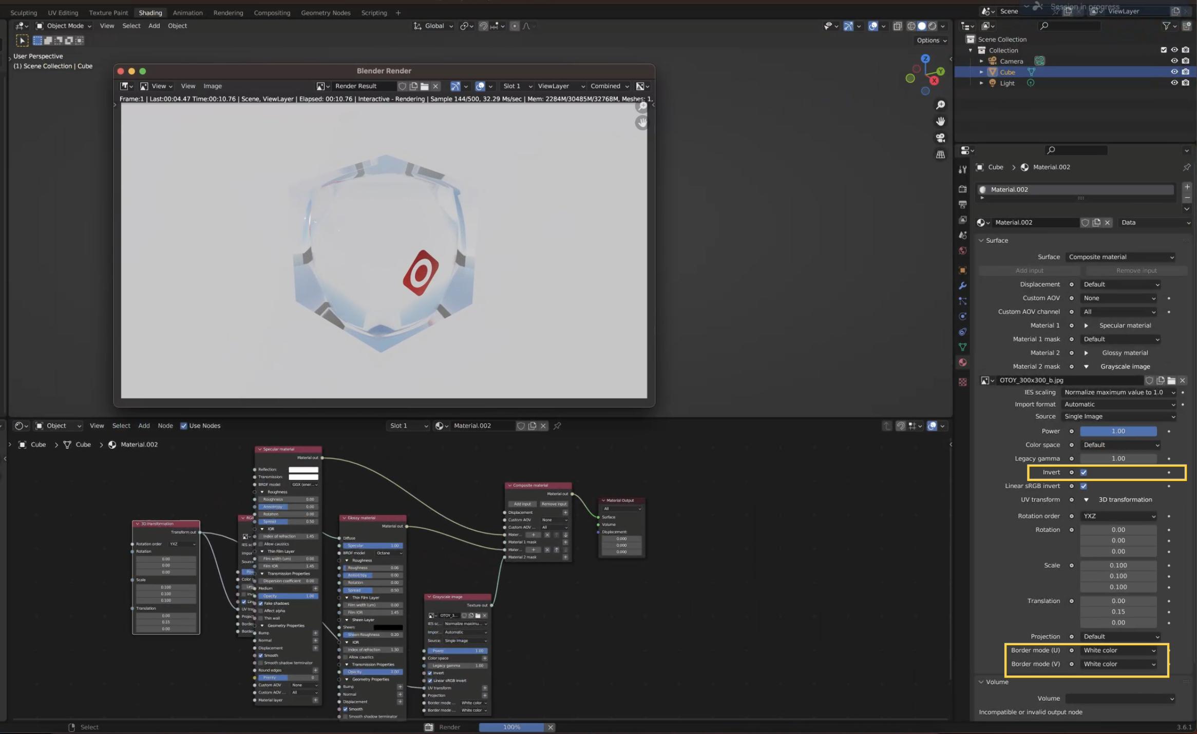

Hi, somehow I connect the decal color texture to the Glossy and the mask is gone, the specular is gone too. It has been happening since I started trying it. Attached you can see the file with the png's embedded and the blender file.
I wonder what am I doing wrong if it is quite an easy thing.
Cheers!
composite mix.blend
(5.65 MiB) Downloaded 787 times
Once the RGB is connected the specularity is gone
Posts: 10549
sorry, my fault, the Mask texture was setup incorrectly.
In this case, the border Mode should be White Color, and should be inverted.
I have disabled the Thin Wall option in the Specular material, to better see the effect.
Here is the corrected version:
CompositeSpecularDecal_b.blend.zip
(130.05 KiB) Downloaded 788 times

I swear I tried all border mode combinations and it was not working :)
Now from your file, the setup is working.
Thank you so much Beppe!!!!

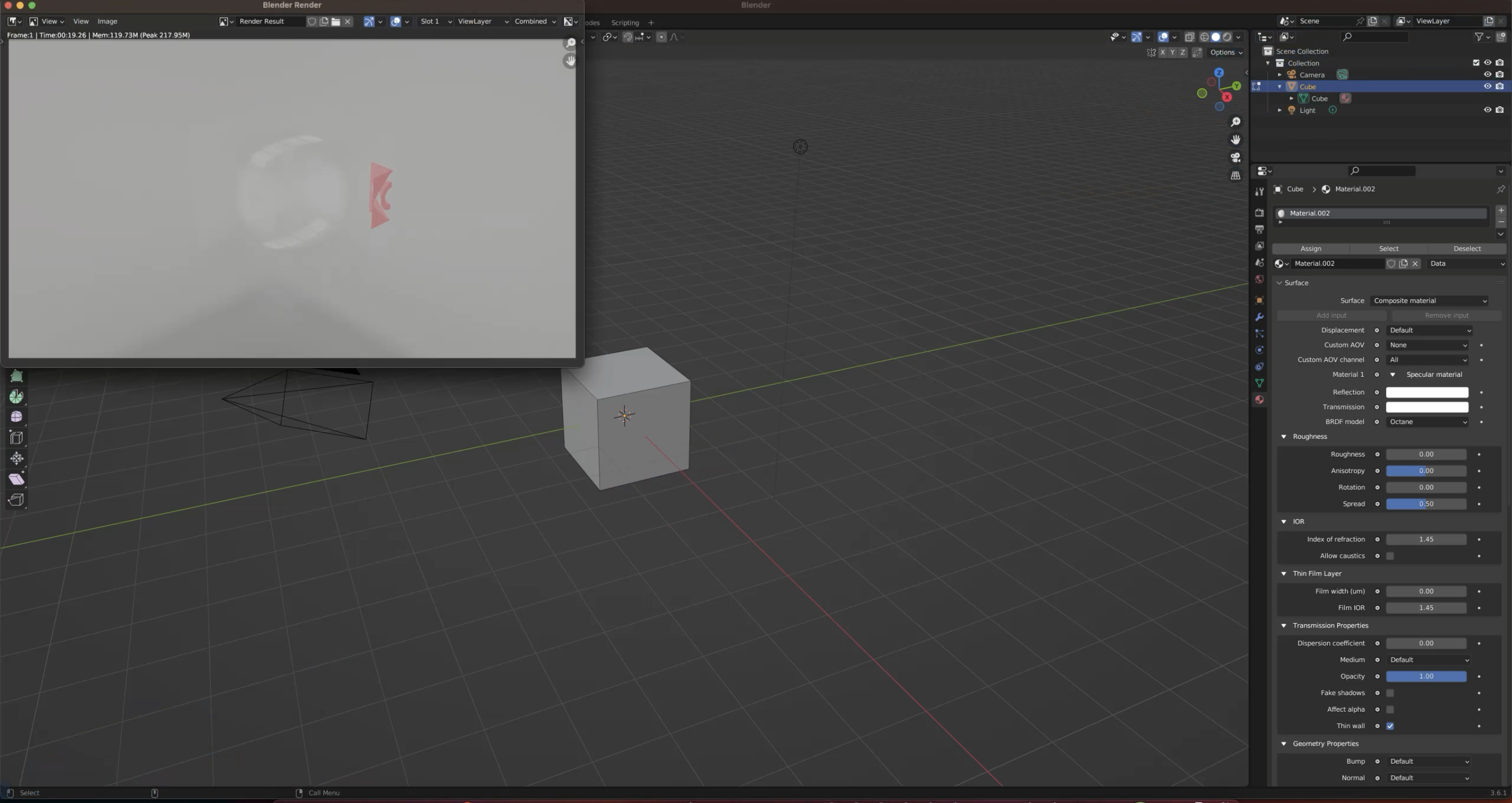

Quick question:
Is round edges working for you all? I'm on the newest version on M1 and octane doesn't render the geometry of the edge correctly.
It seems it does render the light of the round edges, though (see screenshot).
Has anyone had this issue?

@baugestalt:
I need to know which exact version of plugin you are using, so please go to c4d menu Extensions/Console, (Shift+F10), and share a complete screenshot of the panel, or copy paste the default console output in your answer, thanks.
Then please share your cube scene, so I can check your settings.
ciao,
Beppe
