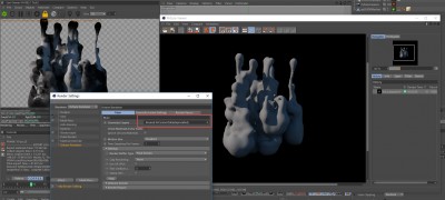

Hi, awesome work on the v4 build!
I have an issue with the Vertex Color Tag, it wont render properly to the Picture Viewer. It does however render correctly in the Live viewer.
https://imgur.com/a/0UswOPf
Here is the scene file.
https://we.tl/i5ErEHFaIu

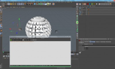

Hi aoktar,
Panoramic camera works very strange. Or i do something wrong.
In cylindrical mode it show me nothing.
Project:
https://mab.to/2yeqlclXz

mudakisa wrote:Hi aoktar,
Project:
FovY should be smaller than 180.0 degree.

rleuchovius wrote:Hi, awesome work on the v4 build!
Why did you set to deprecated method? Reading the information about options that would be great to understand background processes.
