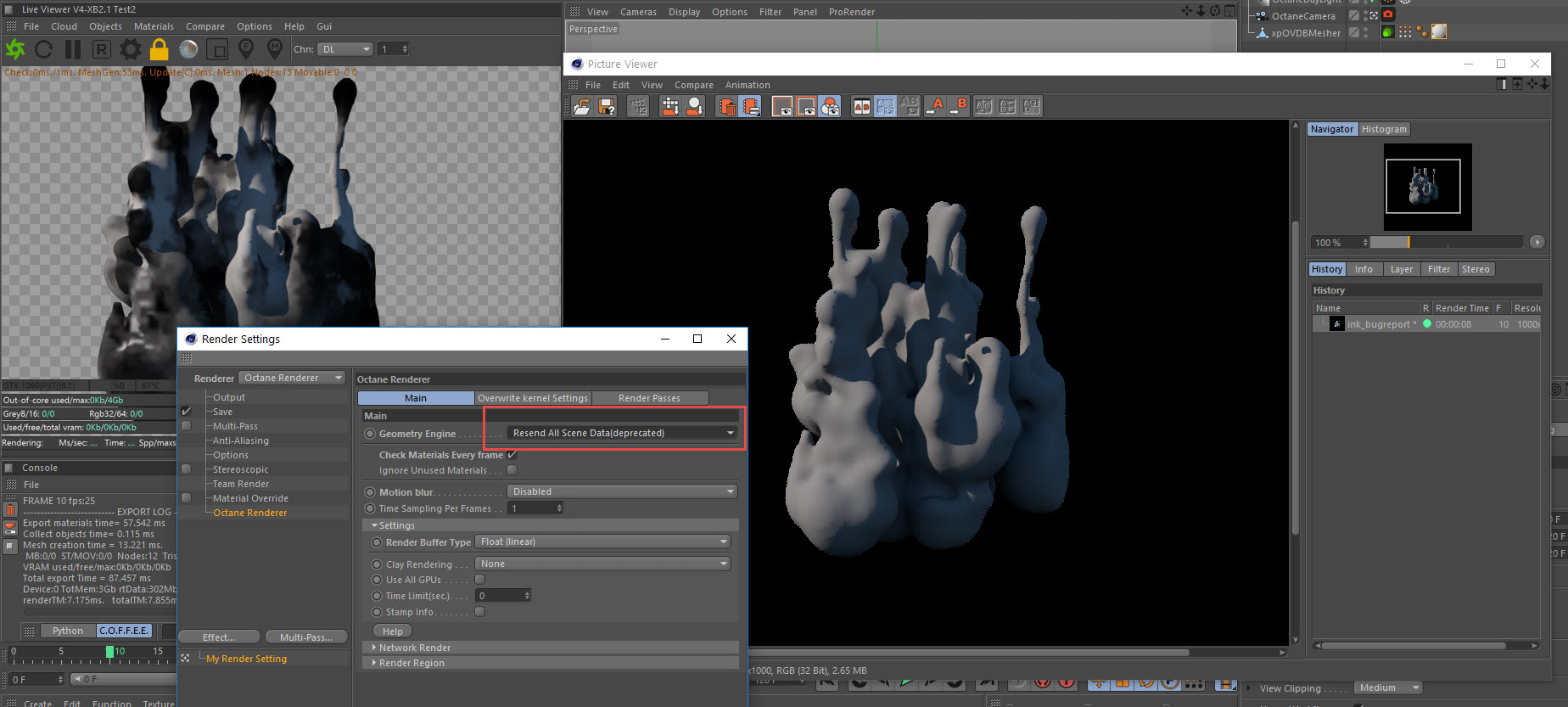

Hi, awesome work on the v4 build!
I have an issue with the Vertex Color Tag, it wont render properly to the Picture Viewer. It does however render correctly in the Live viewer.
https://imgur.com/a/0UswOPf

rleuchovius wrote:Hi, awesome work on the v4 build!
Here is the scene file.
https://we.tl/i5ErEHFaIu
Why did you set to deprecated method? Reading the information about options that would be great to understand background processes.
