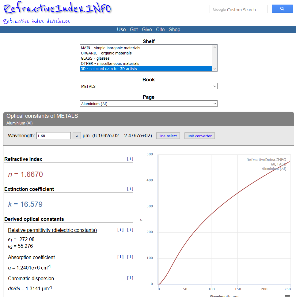

Regarding the metal shader, the K value maxes out at 8 while some metals have a K value of 12, 16, etc...does this matter?
