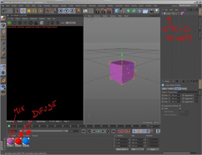

I Think is something about the new mix material support on COPY/PASTE
If i duplicate an object with mix material, holding ctrl+drag works fine, but if I copy the object with mix material and paste in same scene, it duplicates only the mix material.

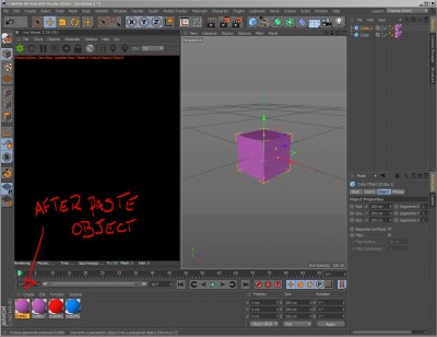

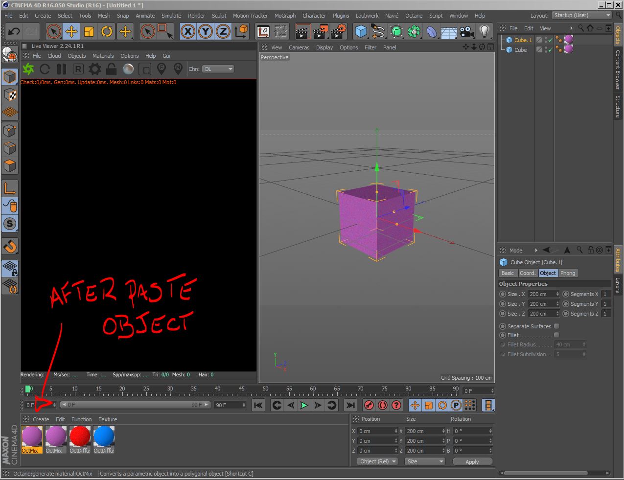

aqcoelho
Posts: 24
Joined: Tue May 13, 2014 4:04 am
Sorry, no video capture, buti did a screen shot,
If I just drag the object holding Ctrl to duplicate, works fine and dont duplicate the mix mat
