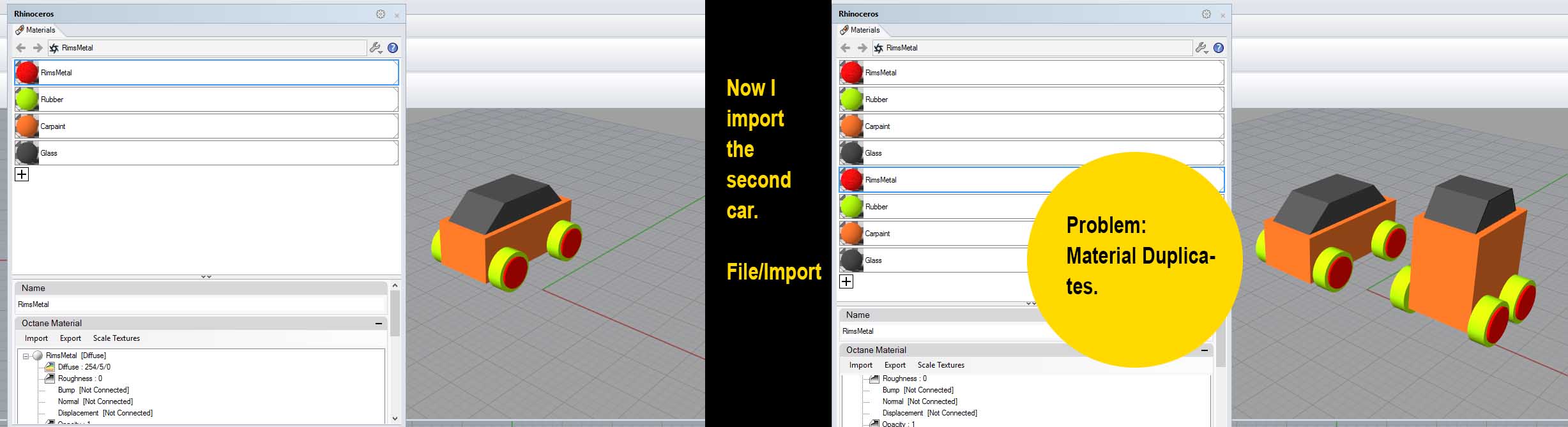

The behavoir for the material is the following:
Lets say you import 10 cars (one after the other) into the scene.
The car materials look as follows: Tire_Material, ClearGlass_Material, Emissive_Material, and so on...
The materials have mostly the same names.
In the material editor there are now 5 times the materials with the same name.
Therefor it would be useful to make a descission about what happens with materials with the same name: replace, rename, or keep exsisting.
The other related question is if it is possible (afterwards) to clean all materials in a way that materials with the same name are merged and objects are re-assigned respectively.
With this function / script the problem of material duplicates could be solved in a 2-way process.

Hi Paul,
the problem occurs if the materials havent been created in "one go" before.
Please follow the steps to recreate the problem:
1. Open up scene "Car1"
2. Import "Car2" into this scene
3. Check the material editor
You will find now material duplicates with exactly the same names.
A "merge all materials with the same name - script" or "a "import choice dialogue" for replacement / renaming / keep existing materials could help.
Otherwise there will be hundrets of unneccessary materials if you import multiple cars or similar things.
Let me know what you think and if you can reproduce this.
Thank you
Attached is the demo scene and screenshot.

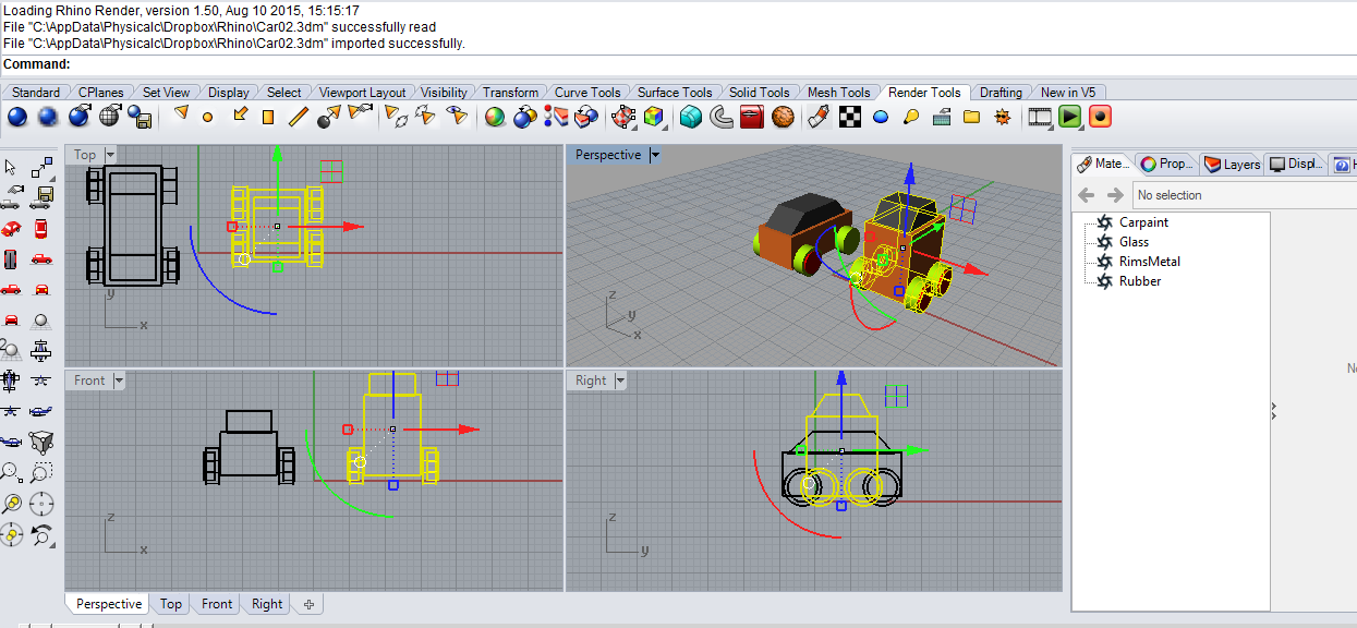

Hi Paul,
I have created a screen recorded example.
It seems that you don't have these material duplicates in your scene and I don't know why.
I am running the latest Rhino release for PC on Win10.
Is there somebody who can write a short script for the clean up. So we can add this to the toolbar... ?!

If I follow the same steps as you I don't get duplicate materials - sorry. I suggest asking in the McNell forums why this would be the case.Hi Paul,
