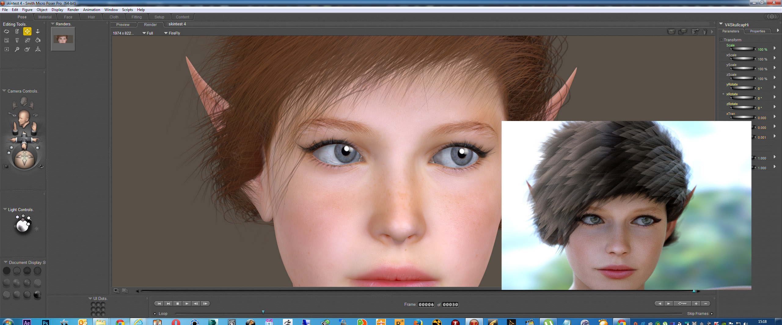

I've a quick question about dynamic hair within poser.
This is actually the first my tried it on Octane render. As a requirement to do is a small bit of animation and it was only way I can think of doing it .
It seems to render fine in poser but when it comes to octane it doesn't displays hair?
The only thing I can see at the moment is a clump that looks like. I hat rather than anything else.
I think a while ago you did discuss this and it's not working?
I take it this will be fixed at some point in the future? Because obviously is quite a limitation if we can do dynamic hair?
Octane renders polygons - and Poser is providing a vertex line for each strand of hair - so Octane converts each hair strand to a polygon by joining the to ends of each hair strand together. ZB on the other hand is providing each hair strand as a polygon solid, which is why that works in Octane.
Yes, this will be rectified at some point.

I found this utility on the net, but haven't tried it yet. Maybe it could help with imported hair?
http://www.sharecg.com/v/27296/gallery/ ... -converter
btw ch0pper, can I ask what model are you using for your renders?
face_off
Posts: 15811
Location: Adelaide, Australia
That app looks like an ideal solution! Pity you have to go outside Poser to do it - but that is probably needed for performance reasons.

helgueras its custom figure. and textures
yes that exe works for 6 year old program i am quite surprised.
but they reason i was using dynamic hair was i was trying doing sum animations with it.
wind etc. but now converted it static hair it shame.
ah well the quest goes on
Yes - that solution will only work for single frame images - not animations. If you find a python algorithm to convert vertex stands to polygons, I can add it to the plugin - so it will most likely be too slow to be practical. A better solution would be native support for strand hair in Octane. So make sure you've put your vote in on the "New Features" survey. http://render.otoy.com/forum/viewtopic.php?f=9&t=37045.
