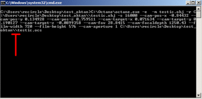

Yes, the 2008 script is not working correctly for animation. Working on an update as we speak..[email protected] wrote:Hi all... it seams that I have exact problem like N1K..
I've setted my scene, in max2octane I've set it all like this, and here is the error
so after I pressed Render, I've set my scene the way I like, and saved it, I than imported it with "use existing project", and pressed render animation
first I got that cmd window... than it entered octane and I got the "not useable" error, and 100 times like that (my animation had 100 frames)
but once I forgot to click use existing project after I set my octane the way I want it...
than it started to open 100 octanes with cmd window and they all started to render, but the weird thing is that all materials and hdri maps were in octane like I adjusted them, only the aperature for DOF was high and blurry, and I do not want that, than I had to restart...
is this a bug or?
Thank you

Updated script (1.022_2008b for max2008) available for download in the second post in the thread!
