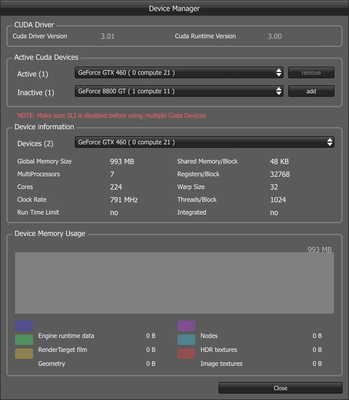

realTimer wrote:This is the new GF104 with superscalar architecture, but only 224 of the 336 cores are used according to the device manager.
Nvidia's GF100-series had 32 CUDA-cores per Streaming Multiprocessor (SM), the new GF104 has 48 CUDA-cores per SM. It is entirely possible, that a software coded for the older hardware (old 400-series) must be modified before it can use all those CUDA-cores in GTX 460!
If so, the rendering speed of Geforce GTX 460 should increase 1.5x after the fix which allows using all the CUDA-cores. ;)
Does anyone with the new GTX460 notice any change in compute model ?
is it 2.0 or 2.1 ?

Mine Club3D GTX460 1Gb says compute21
