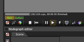

I just downloaded Octane X 2022.1.1 which mentions improved MacOS performance and I'm happy to report the improvement is HUGE.
The OctaneXBench_VolumeDenoiser scene that Beppe provided is rendering in 30 seconds on my M1 Max Macbook Pro, compared to 44 seconds on 2022.1
Super excited to try it out on C4D.
People with M2 Max Macs, please download 2022.1.1 and re-run the benchmark, I wonder if there are bigger improvements for you.
