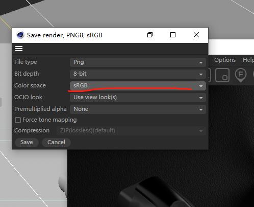

c4d crashes when saving image in live viewer and selecting color space
octane 2021.1.6 r5
cinema 4d 2023

blackcat321 wrote:c4d crashes when saving image in live viewer and selecting color space
octane 2021.1.6 r5
cinema 4d 2023
Can you reproduce it? And describe what's the conditions to reproduce it here

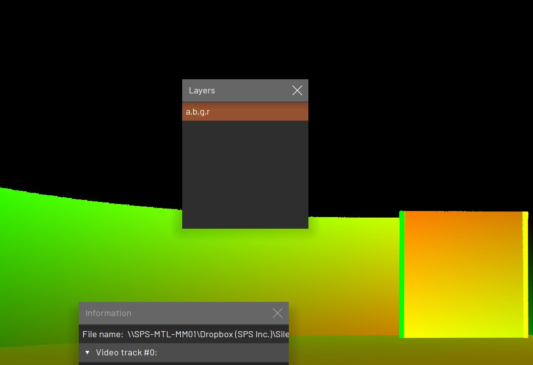

SilentPartnersStudio
Posts: 12
Joined: Mon Feb 15, 2016 4:38 pm
aoktar wrote: The thing is working with any older version? I don't have AE to check but it looks like working with the other softwares
So I have explored this a bit more, and I think it comes down to AE being case sensitive to the channel naming.
When I bring in the UV pass it is black...and when I add an extractor plugin it defaults to Capital letters for the channels.
But when I manually assign a channel, the channels are labeled lowercase...but the manual assignment works.
When I check another pass that was rendered the channels are labelled correctly with Capital letters
Checking in DJV I can see that the UV pass is indeed written with lower case letters for the channel names
But when viewing a RLE encoded exr the UV layer has capital letters for the channel names
Obviously it would be great if after effects was not case sensitive here...it seems like most apps are not case sensitive.
But also it would be wonderful if octane was using consistent channel naming conventions. Like ALL caps for channel names rather than switching between caps and lower case.

blackcat321
Posts: 18
Joined: Fri Mar 06, 2020 3:08 am
octane 2021.1.6 r5
cinema 4d 2023
I tried to create a new project, open the live viewer and export the image, but it still crashes when I select the color space.
2021.1.6 r4 no problem
