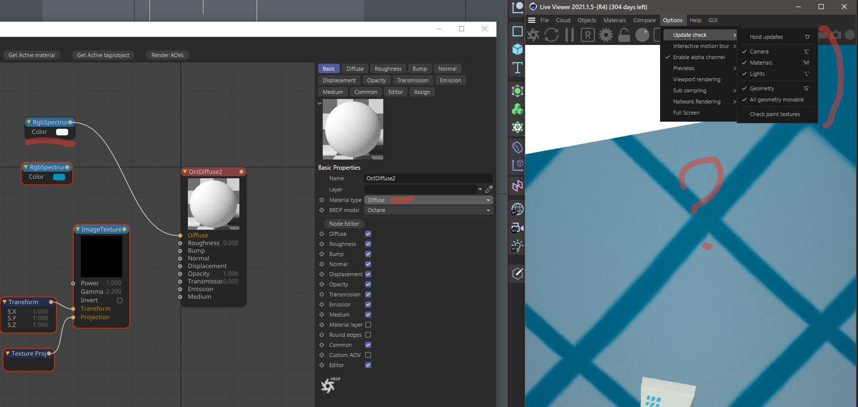

Please see screenshot
I've changed color from blue to white, and material type from Glossy to Diffuse, but no update in a liveviewer. Other nodes like projection or transform with no updates too.
Updates come after pressing Send Scene button only.

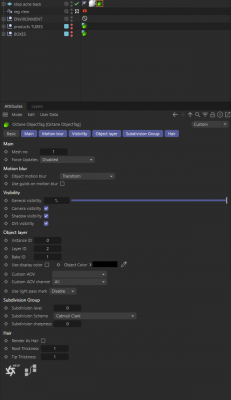

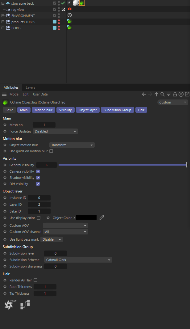

- material that has update trouble is assigned to an object with ObjectTag (I'll put a screenshot with settings at the end of the message).

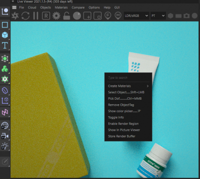

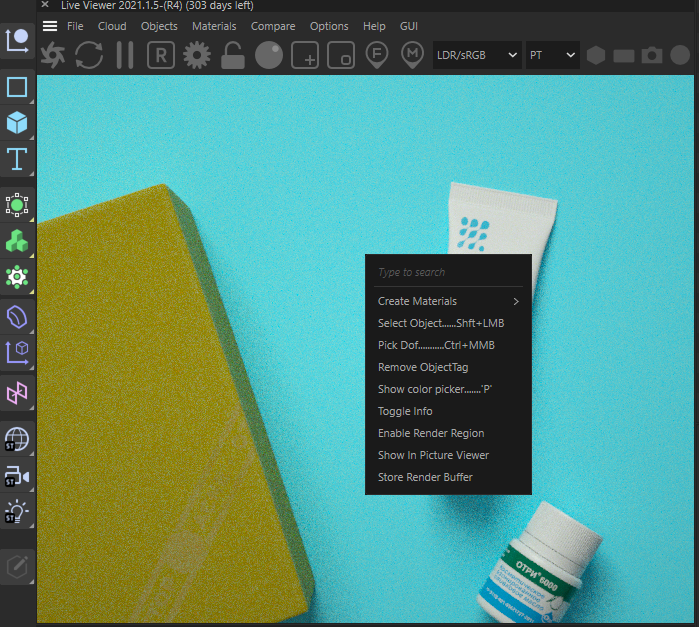

- in a Live Viewer if make right click over that material (assigned to obj+objtag) - menu shows like there is no material assigned - offers to create new material and not offer to select/copy/paste (screenshot below)

ObjTag settings
ObjTag settings
right click option
right click option
