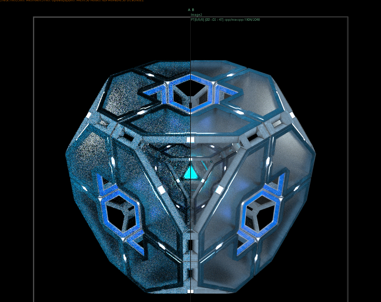

Did you see the workaround above?CCIDgfx wrote:I just wanted to update that I went back to 2020.1.5-R4 and store render buffer is working. I just saw another person having the same issue so I know it's not my machine now.
(And yes, it's not your machine
C4D 2025 | Win10

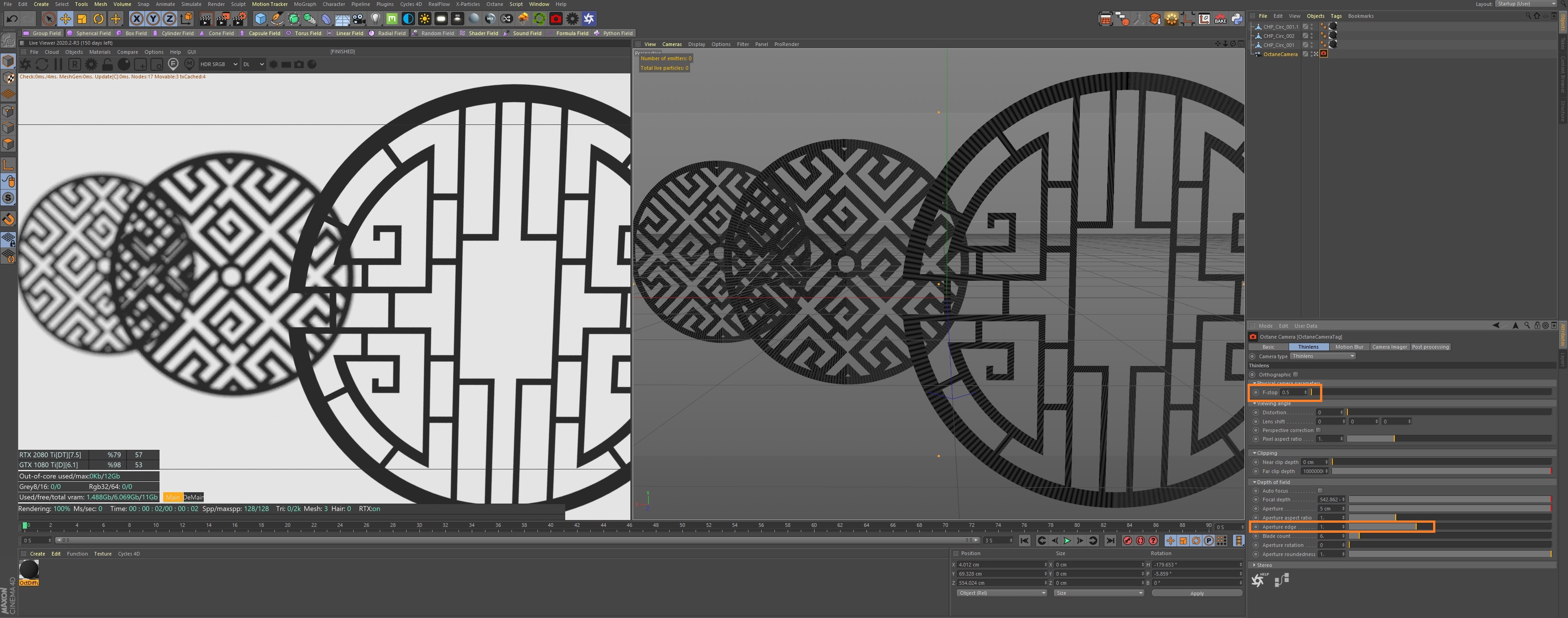

Thank you so much dude =)zoppo wrote:I have the same issue and I don't intend to switch from R20 soon (lots of plugins ...).aoktar wrote:EDIT: It's an issue for R20, can't fix it. Why do you prefer R20?
The Live Viewer A/B view is not working, store render buffer is not working and this is a HUGE problem that should be dealt with.
Now, my friend useruser found a workaround, so Aoktar, I think this should be fixable in R20:
Enable "Lock resolution" and change the y-axis resolution to something other than 1:
That's it. You can change both values so they match, but the important one is the second one.
It does even work when you set it to 1.01 and leave the other at 1.
