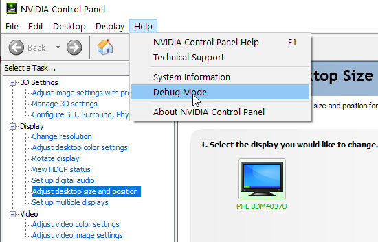

I cannot see any crash or error messages in this log. Could you try with 441.66 and Debug mode selected from Nvidia control panel?

This is the new log with the new pilot and debug mode.
I notice the crash appears when octane check octane daylight and hdri.
c4doctanelog.txt
(303.47 KiB) Downloaded 301 times
