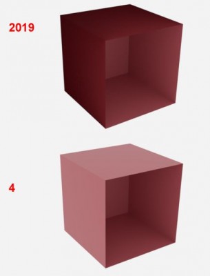

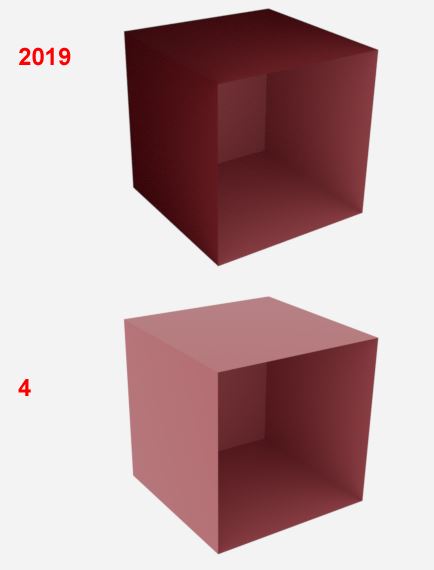

Double sided materials are rendering different in 2019 compared to 4/2018.
It seems the opposite side of polygons no longer have any reflection.
The polygons here are facing inward. You can see in 2019, the outer faces are much darker now:
This is going to break things like tree leaves, grass, sheets of paper etc, which use a single poly for both sides.

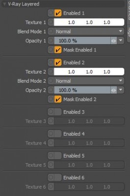

Lino, the composite material is like a MIX MATERIAL with more than 2 inputs.
For textures, we would need something like the MIX TEXTURE, with more than 2 texture inputs.
I agree it would be really handy

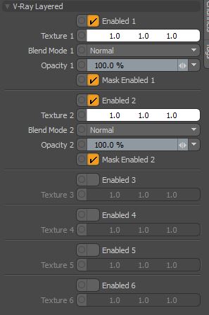

EDIT: In vray for modo, we have the "V-Ray Layered" node that has 6 texture inputs. What I like about this is that it also supports BLEND MODES (multiply, add, screen etc similar to photoshop)
Win10 Pro / Ryzen 5950X / 128GB / RTX 4090 / MODO
"I am the resurrection, and the life: he that believeth in me, though he were dead, yet shall he live" - Jesus Christ
linograndiotoy
Posts: 1496
funk wrote:Lino, the composite material is like a MIX MATERIAL with more than 2 inputs.
Oh, got it! Thanks!
A Layered Texture mixer node, offering Photoshop-like blend modes would be a wonderful addition. The good news is that OTOY is totally aware about that. ;)
