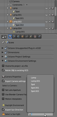

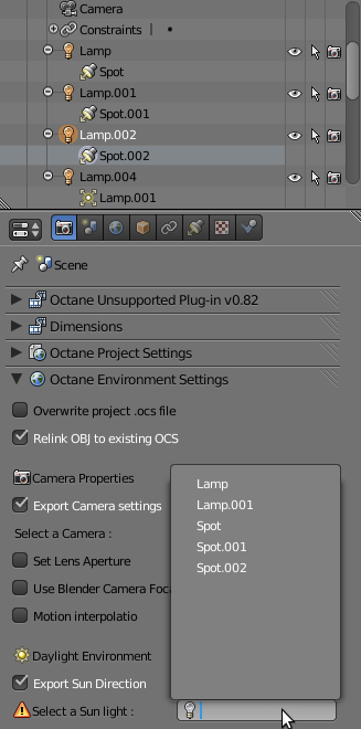

Just a quick note so you know what happens with the way of selecting the Sun in this new version: the list shows the actual lamp names, while you may have expected the object names. The 'real' lamp data doesn't not always match and you could get confused.
In the exemple below, if you want to use Lamp.002 you must select Spot.002 (and even better: turn that into a Sun for Octane...). Don't be confused with 'Lamp' being in the list, there's a 'Lamp.003' having a 'Lamp' child somewhere else. Only look at children names for the moment.
