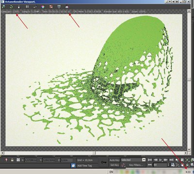

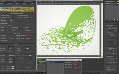

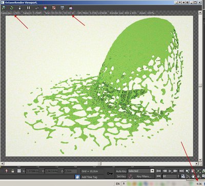

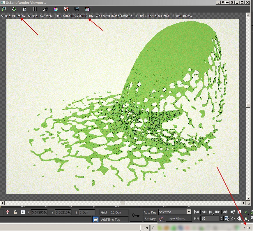

thanks for the reply. well, maybe this attribute is not in alembic file. you can do so that could render at least one frame from .bin sequences? when I put two checkboxes in movebale proxy and vertex motion blur, octane shows speed in 1 Samp/pix and picture can be seen jittering colored noise during the render. .bin sequence loaded using realflow mesh loader. or you tell me again that you don't have the owners realflow? why other renderers don't have such problems, they bought realflow?
That noise is noise caused by spectral sampling and which will go away after more samples/pixel. Maybe have a look at already existing scenes and investigate how physically based rendering behaves.

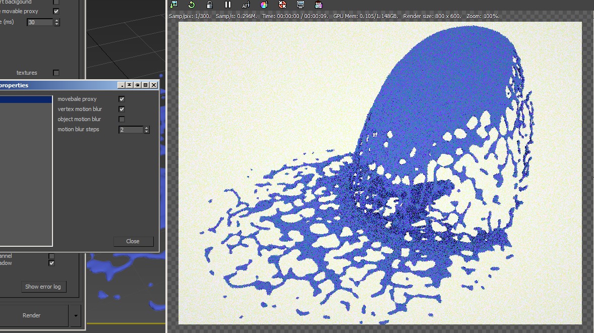

mikinik wrote: when I put two checkboxes in movebale proxy and vertex motion blur, octane shows speed in 1 Samp/pix and picture can be seen jittering colored noise during the render.
here's the error about which I spoke earlier. over time nothing has changed.
