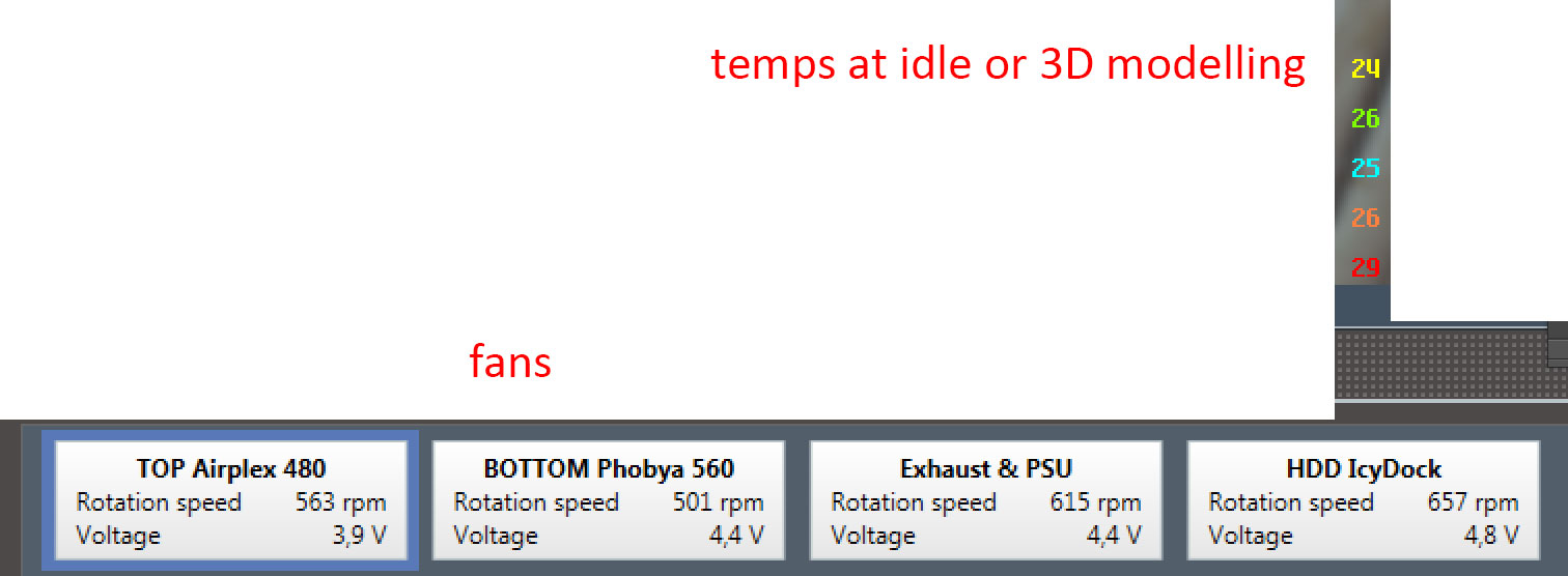

What a tempsYou got there!
4090+3089ti & Quad 1080ti
http://www.tapperworks.com
smicha
Posts: 3151
Location: Warsaw, Poland
These temps were actually over constant 3d modelling in modo and rendering as preview (up to 100 samples).
But at Idle and without Octane usage temps are lower and fans are set to possible minimal speed.
