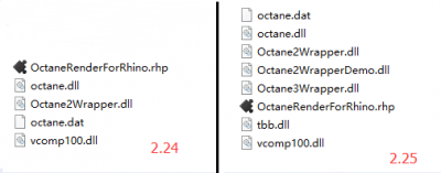

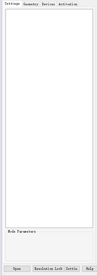

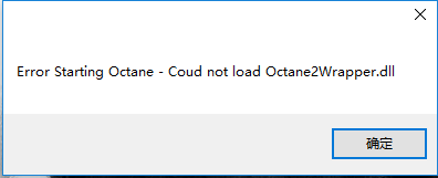

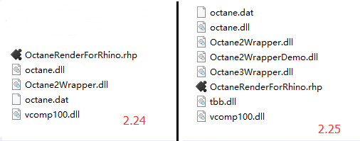

My systerm: win10-64bit, GTX980M(driver version: 364.72), Rhinoceros5sr13(version: 5.13.60326.15590, 2016/3/26), OctaneRender for Rhino 2.25_0_63
But error,
How can I do? What about the files of this two version? The *Wrapper*.dll has three dll files in the OctaneRender for Rhino 2.25_0_63.(also Octane2WrapperDemo.dll)

Alxen, it looks like there is a problem with the installer, which I will need to fix. For the moment I have removed this build.

Hi paul,
I have download the new OctaneRenderForRhino_2_25_0_63.rhi, It works well. Thank you for your support.
