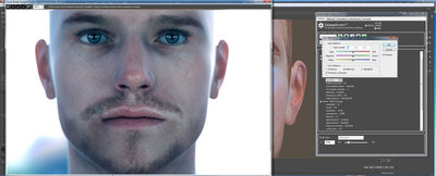

I have a new feature request is at all possible Paul
I've enclosed the mockup of what I would like to see if possible which I'm sure is possible
imager [camera]
On the main settings
just by saturation
Is it possible to have a colour balance
To change our RBG values?
To the picture exactly as it does with saturation?
As it's a perfect way to get your picture right 100% of the time
In my view is of course
W7 64 bit |I7-3970X | GTX 780 X2(6GB) GTX 780TI X2 | 64 GB DDR3 RAM
Real Skin & real hair for Poser / DAZ Studio OctaneRender/iray - coming soon
face_off
Posts: 15799
Location: Adelaide, Australia
Chopper - is what you are after "whit balance"? And if so - would adding a white balance picker to the Viewport resolve your issue? That's the way it works on Standalone (so you can try it there to see if it addresses your requirement).
Paul
