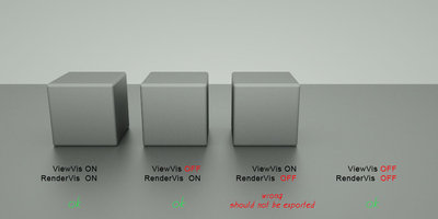

With 7.5 it works.Amplitude wrote:cool !
btw don't want to be nitpicking but the rendervis flag does not work with my version... (both object level and layer level).
Meshes will be exported when view visibility or render visibility is on.

well it works but not completely like it shouldWith 7.5 it works.
Here is what I mean: could you modify that in the next build, pleaase

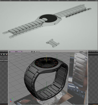

Wouhouu, all right first feedback:
- smoothing errors I got with the original softimage exporter seem to be gone! Great.
- materials are exported nicely without duplicates. Excellent
but... deformers aren't taken into account anymore.
(curve deform located in the Shape Modeling Mode)
I think your exporter is looking only at the Modeling construction Mode instead of the whole construction stack ?
