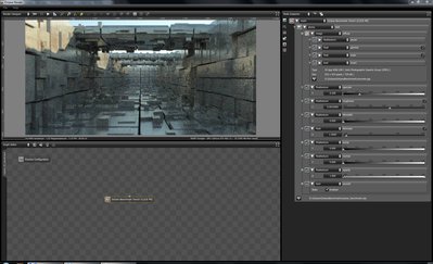

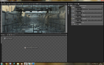

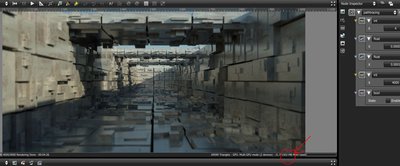

goranmax wrote:
buda wrote:
goranmax wrote:
Swith to pathtrase mode...
but please tell me is that good or not
high numbers good ?...low numbers bad...or ???
Yes it good ))))
Comparison with the result GTX 470 without overclocking
pathtracing mode: 2.69
directlighting mode: 8.84
GTX 280
directlighting mode: 4.80
Your result in directlighting mode: 10.18

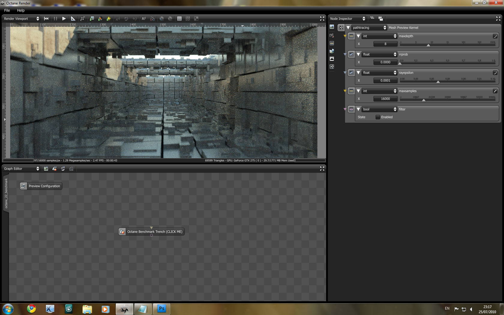

Here's what I get:
Windows 7 64bit
Phenom II x4 965BE
MSI Lightning GTX 275 1792 MB
4GB Ram
Pathtracing: 1.29Megasamples/sek
Directlighting: 4.8Megasamples/sek

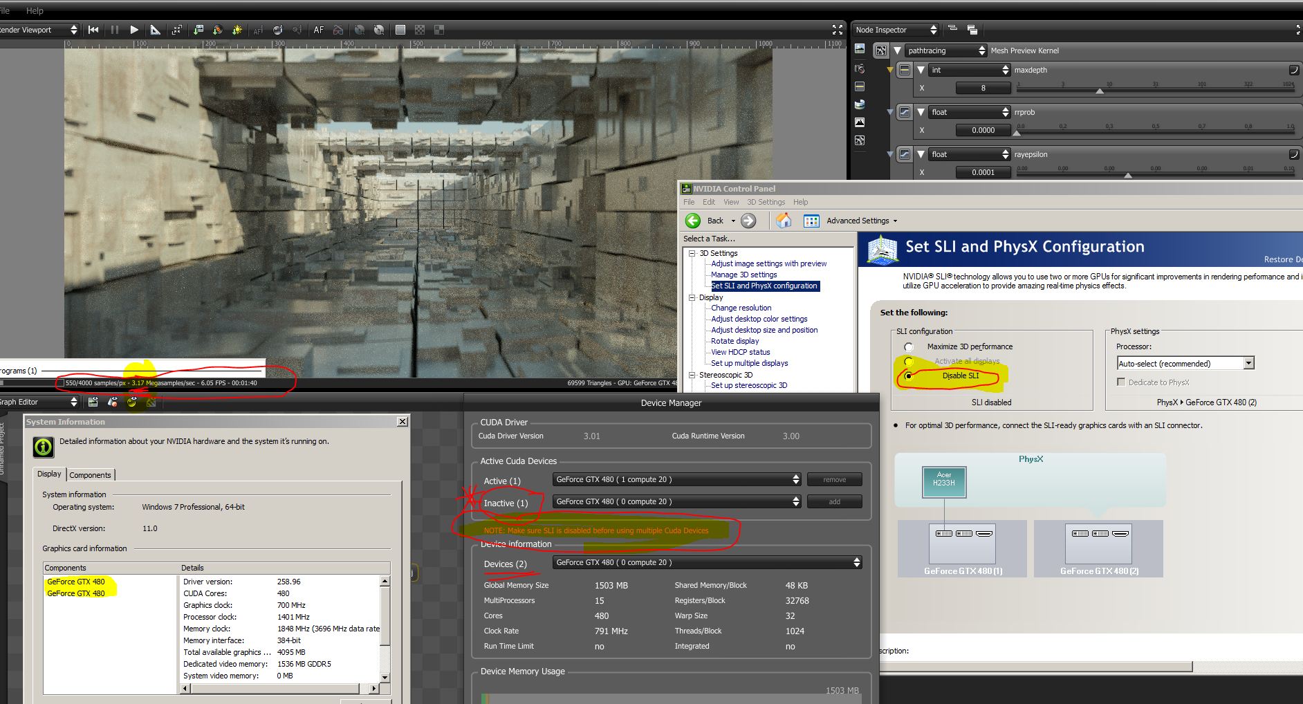

Can't seem to get my dual gtx 480 setup to work. Any suggestions?

imensah wrote:Can't seem to get my dual gtx 480 setup to work. Any suggestions?
You just add the 2nd GPU to the setup using the 'add' button on the 2nd inactive device list so both cards are in the active devices.
The SLI text note is always there. It's just information, it does'nt mean SLI is on or off.

Ok got it to us both gpu's but the 'add' button seems to be greyed out sometimes. seems it has to be set nbefore loading a scene.
Also shouldnt the memory read 3000 as there are two cards instead of 1503?

No, unfortunately the vram is not added in cuda systems.
If you have 3 gfx489 it also stay at 1500 MB.

Thanks fo the info!
