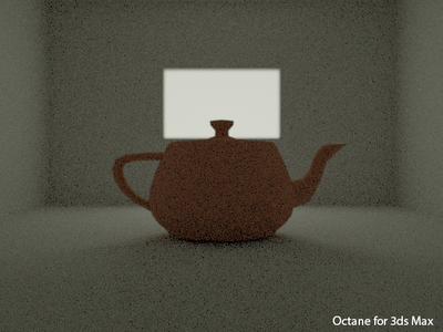

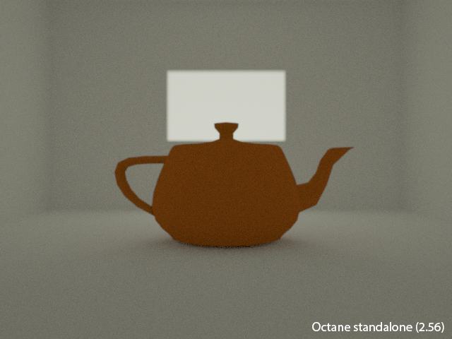

MaTtY631990 wrote:I did another test scene between octane standalone version and octanefor3dsmax version. Simple box with teapot which both have diffuse materials. Pathtracing was used to render for 1000 samples. This sounds like a bug to me unless someone would mind trying the same setup and confirming this, so I know it is not problem with my hardware but an issue with the plugin.
octane standalone
octane3dsmax
Can you share this scene?

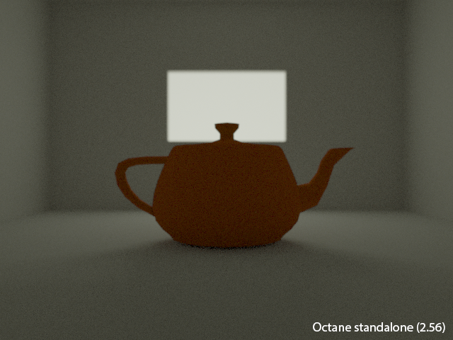

I did similar test and I can say that octan standalone (beta 2.56)is faster and less noisy.
Here first test.
Scene settings:
Kernel: Pathtracing 1000 samples (other by default)
Background (color max/octane): (255,255,255)/(1,1,1)
Materials: both diffuse material, gray color (230,230,230)/(0.9,0.9,0.9), red color (122,0,0)/(0.5,0,0)
Imager: exposure 1, f-stop 2.8, ISO 100, gamma 2.2, Agfacolor_HDC_400_plusCD
Render times: Octane for 3ds Max - 40 sec, Octane Standalone - 35 sec
I attached scenes (for 3ds max 2012 and standalone)
PS: I did some mistake - corresponding color value in max (to float value 0.5) has to be 127 (not 122). I've been always bad in math :) But it doesn't matter for the test results
PPS: I forgot to say - I have GTX 480
max_scene.zip
(18.99 KiB) Downloaded 269 times
octane_scene.zip
(35.61 KiB) Downloaded 281 times

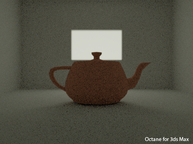

rman1974
Posts: 72
Joined: Tue May 25, 2010 1:10 pm
Location: Moscow
I reduced gray color value (walls material) from (230,230,230)/(0.9,0.9,0.9) to (122,122,122)/(0.5,0.5,0.5) and I've got this result. Less fireflies, but standalone version is still much cleaner.

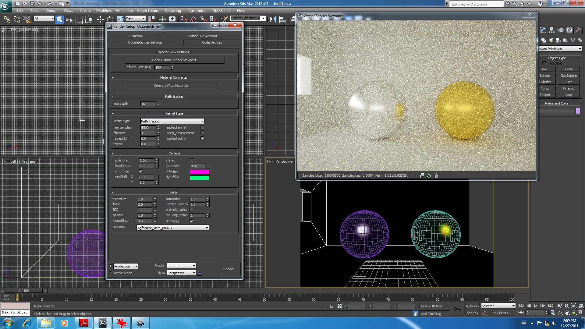

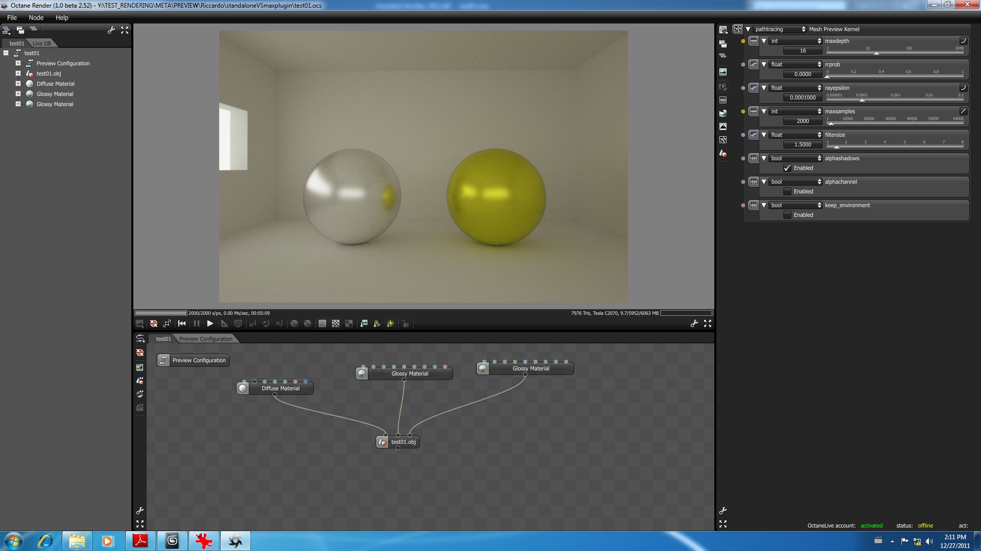

I did a different test, based on the render time, in our case about 5 minutes. Standalone version achieve the best results using a small number of maxsamples (2000). In 5 minutes the rendering of the plugin version is worse even the maxsample number is greater (5500).
All the others parameters are the same for both version.
you could also deploy the plugin with:
the blow-up rendering (to normalize the perspective with large value of FOV)
override material in the rendering dialogue window
test01.zip
(157.64 KiB) Downloaded 272 times

This is the link that contains both the OCS file and the max scene.
Teapot OCS and max scenes.zip
(521.77 KiB) Downloaded 293 times
