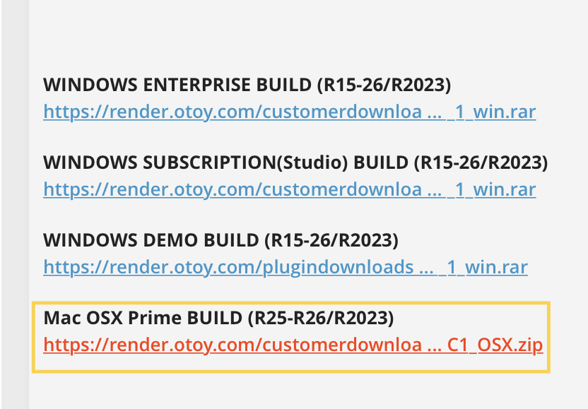

I downloaded the Cinema 2023 build Studio posted here further back in the thread and it doesn't show at all. Even the usual pop ups for verification don't show so it isn't even getting that far. I have C4D 2023 running on an M1 MacBook Pro with Monterey 12.3.1
Posts: 10564
@RegSquires:
With Monterey and M1/M2 chip, you need to install the following version:
https://render.otoy.com/plugindownloads ... R4_OSX.zip
Instructions here:
viewtopic.php?f=85&t=80247#p414534
For C4D 2023, you need to keep the R27.xlib file, and remove both R25 and R26.xlib files.

bepeg4d wrote:@RegSquires:
Instructions here:
ciao,
Beppe
Thank you Beppe this works great. Seems a lot faster and snappier and it works in 2023 which is great. However the Denoiser is still very slow. Is this coming in another update. As it is its is superb and I am using C4D's built in Intel Denoiser which is pretty good. Thank you for the link
