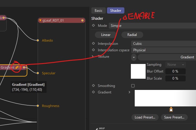

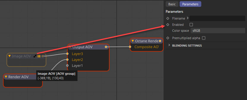

aoktar wrote: Enable linked to dsiable mode of nodes
I don't know where to find, what exactly "linked" ?
To be more precise I thought about composite layer states :
The attachment layer_state.jpg is no longer available
I'm talking about this icon.

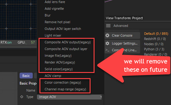

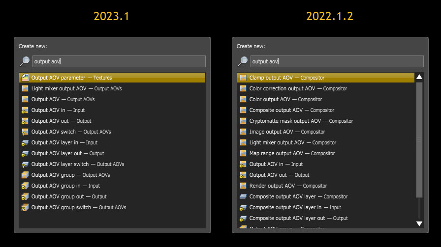

Also don't use the nodes as marked with "legacy", I missed to mark as legacy the "composite AOV output layer". I'll change it for R7.
These nodes are not allowed to be created in 2023.1 Octane Standalone. Only reason to keep these to don't break the backward compatibility.

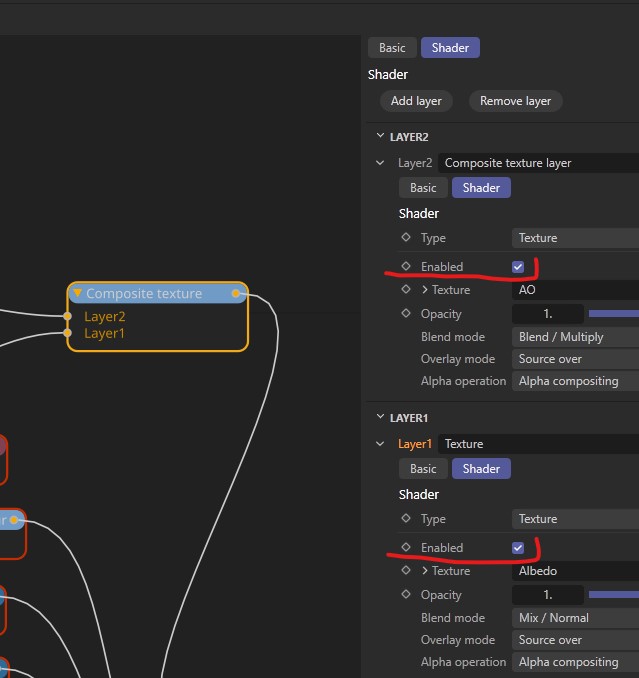

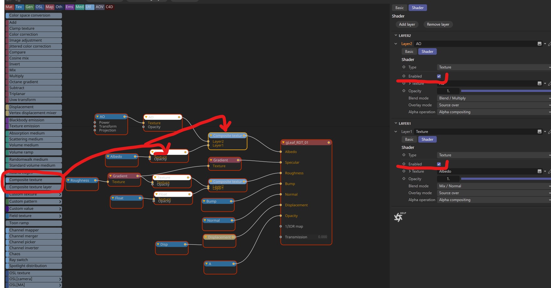

Thank you for explaining but I was talking not about AOV but regular texture, material nodes :) I mean regular composite texture inside material nodes.
I know that there is opacity input but opacity = 0% doesn't upload unnecessary texture from VRam. It needs to be disabled by node. If we have a lot of materials with variations inside it would be great to have such enable/disable switch that can be reached as input to other nodes.

This enable switch for nodes is great when we have many similar materials and want to edit them globally using material multiselection in C4D - we can edit all parameters for all at once. But without possibility to enable/disable individual nodes inside materials.
If you would add this enable switch from nodes to edit controls in C4D material attribute window it would resolve this problem and add more functionality to edit globally selected materials :
Especially for image node.

You have "enabled" input visible in C4D Attribute Manager for Composite Texture Layer - why not to do the same for Image node ?

SSmolak wrote: - why not to do the same for Image node ?
Because it is not available in core side
