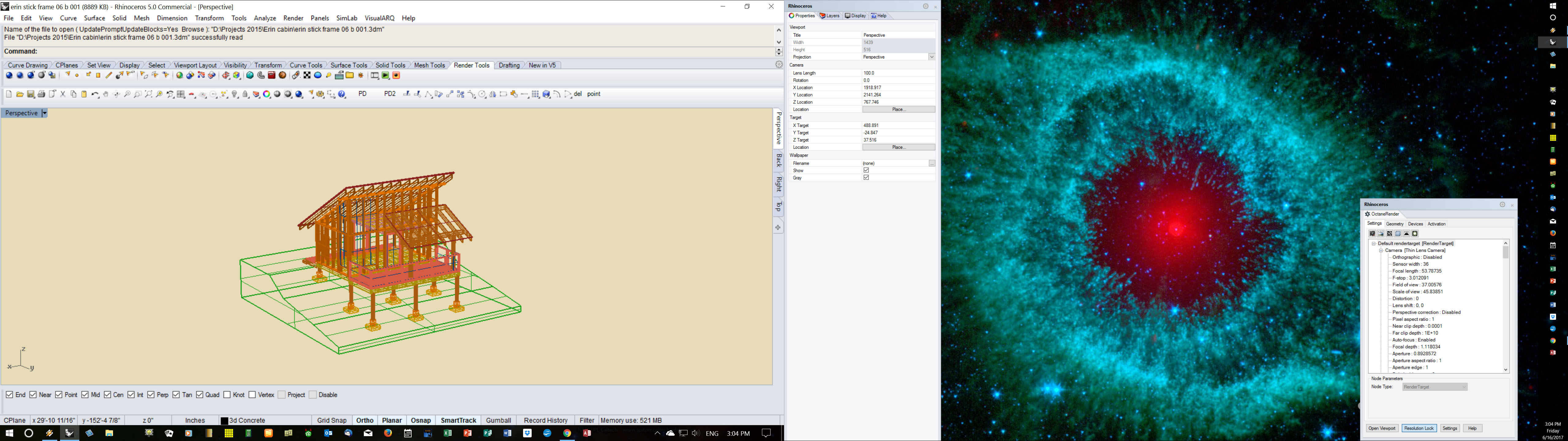

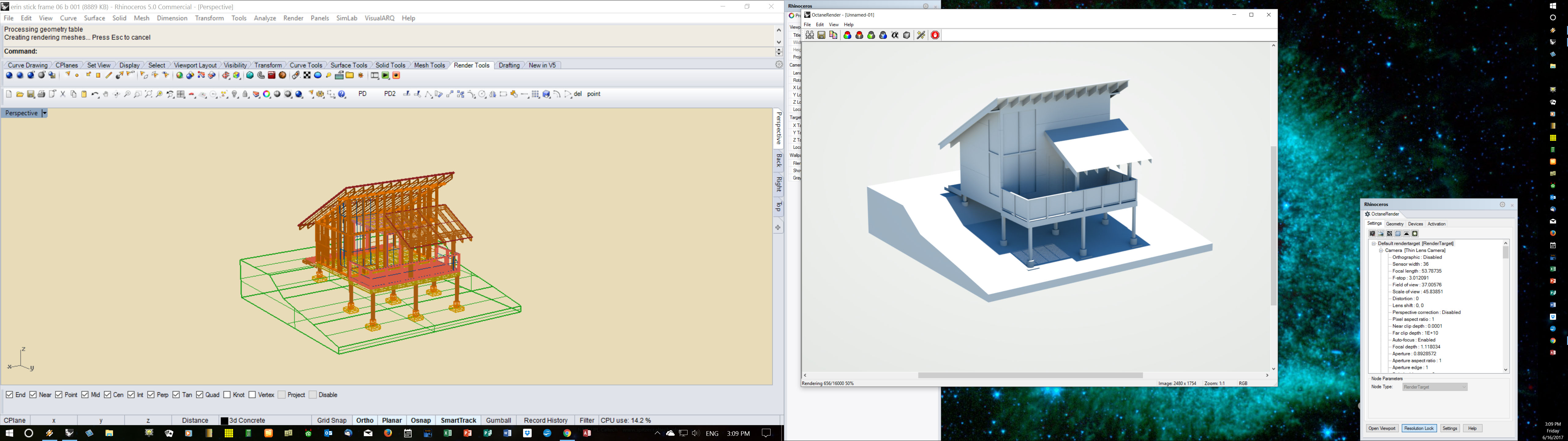

Hi Paul ..
Obviously I use 2 monitors.
The first screen shot is the way the file opens. The Octane tool bar is on the right.
The second screen shot is the render. If I click on the Octane tool bar ('open viewport') it shows that it is opening but no viewport appears.
If I try to open Octane render from the Rhino command line it pops up a window telling me that Octane is already open.
The only option I have at that point is to click 'render' at the top of the rhino screen and than again when the toolbar drops down. Then I get the second screen shot with the render in progress ... but at that point everything is locked except that I can zoom or move the image in the viewport. Otherwise the computer just beeps at me when I click a mouse button.

face_off
Posts: 15822
Location: Adelaide, Australia
That was not obvious until now. I suspect the Viewport is opening off the screen somewhere. You can see the location that it will open if you look in C:\Users\[username]\AppData\Local\OctaneRender for Rhinoceros\config.xml - the ViewportX, ViewportY parameters will be the X/Y screen position that the Viewport will open - what are these pls? And what are ViewportWidth and ViewportHeight.
Cabin 2.jpg is showing the Rhino render window, and not the Octane Viewport. Are you perhaps getting these two confused? You open the Octane Veiwport by clicking the Open Viewport button on the OctaneRender tab. The Rhino Render window will lock until all samples have been rendered by Octane (although you can click Cancel to abort the render).
I would recommend docking the OctaneRender tab in the Rhinoceros tabs window.
Paul

face_off
Posts: 15822
I cannot get the config.xml to open ... every time I try the little circle by the mouse pointer comes on and just keeps turning. It doesn't seem to have an effect on computer operations but it does not stop until I reboot the computer.
Eric - config.xml is a text file, so open it in Notepad or some other editor.
Paul
eric_clough
Posts: 124
Joined: Tue Aug 31, 2010 11:28 pm
Thank you Paul ...
That was the problem. Somehow it got way off the monitor(s).
One setting was 0 and the other nearly 8000
Octane for R5 is working just fine now
eric
