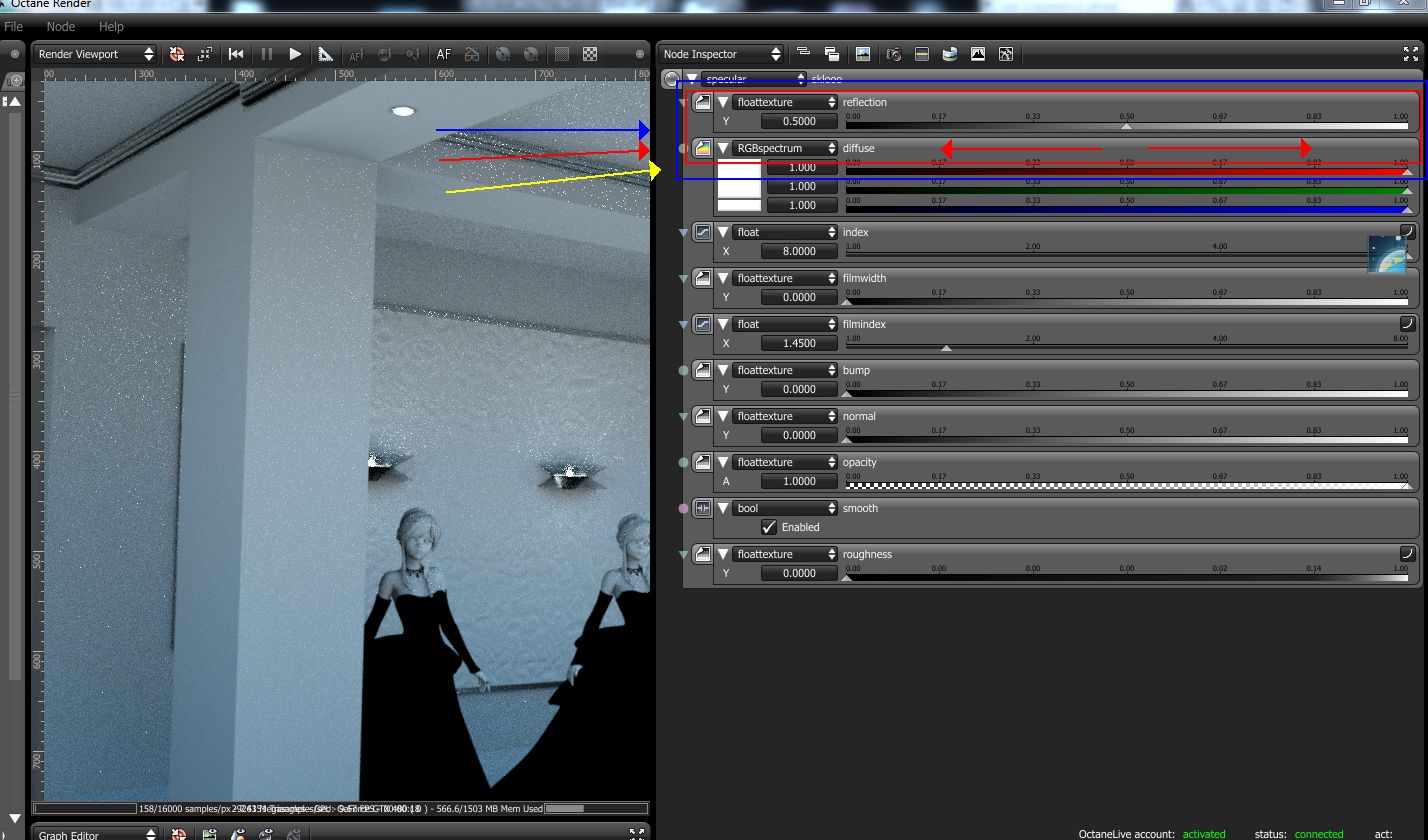

Means what? Could you please be a bit more specific, because I can change the reflection value of a specular material via the slider as well as enter another value? Does that happen in a particular scene or always? Does that happen with all specular materials?Elvissuperstar007 wrote:does not want to move

Restarting the scene helpedabstrax wrote:Means what? Could you please be a bit more specific, because I can change the reflection value of a specular material via the slider as well as enter another value? Does that happen in a particular scene or always? Does that happen with all specular materials?Elvissuperstar007 wrote:does not want to move

Ok, then it's probably better to go back to the old drivers - version 260.99. I haven't tested the new drivers yet, but will have a look later today.Elvissuperstar007 wrote:Restarting the scene helpedabstrax wrote:Means what? Could you please be a bit more specific, because I can change the reflection value of a specular material via the slider as well as enter another value? Does that happen in a particular scene or always? Does that happen with all specular materials?Elvissuperstar007 wrote:does not want to move
