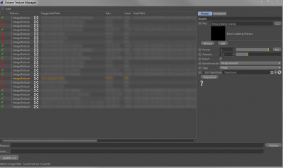

im now checking the great 'octane texture manager'. see the attached image.
there seem to be some missing textures in my materials, but i double checked all slots and nothing is missing. the emodel is rendering fine. in fact, the images that are referred to dont even make sense.
any hints?
also rightclicking and hitting remove, doesnt remove these slots.

momade wrote:ok.
any hints?
Open all materials in the node editor and search for orphaned texture nodes.

Augustronic wrote:
momade wrote:ok.
any hints?
Thank you Augustronic! i'll try that.
