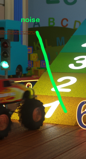

this is what image looks like AO after 3200 samples 720P. Monster truck has two plain disk lights in front. Also number blocks have object emitter lights (glowing diffuse number texture). Seems like when one light shines at another it is impossible to render noise free. We used 12 X 780Ti It took 2 minutes to get 3200 samples. And we do animation so we need 30 frames per second. Hopefully V3 octane will improve noise at night especially when one light shines at another because to make it noise free it would take same mount of time as CPU. Why cannot octane lights be as fast as octane daylight system. At least fake option for animations (like quick 3ds max standard spot light) - light just shines and makes some parts brighter like daylight system (plain spot light with GI or no GI option) ,
Also before truck gets there it renders at 120 samples when truck is in the frame it drops to just 20
