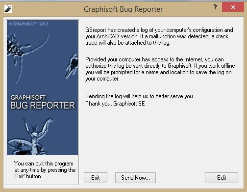

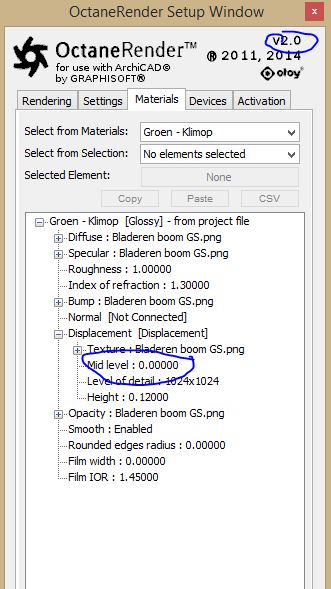

Hi Paul,
I am still getting the ArchiCAD quick quit when trying to change the midlevel parameter (in deiplacement settings)

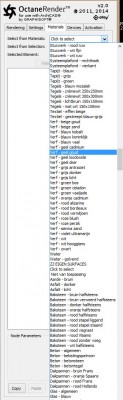

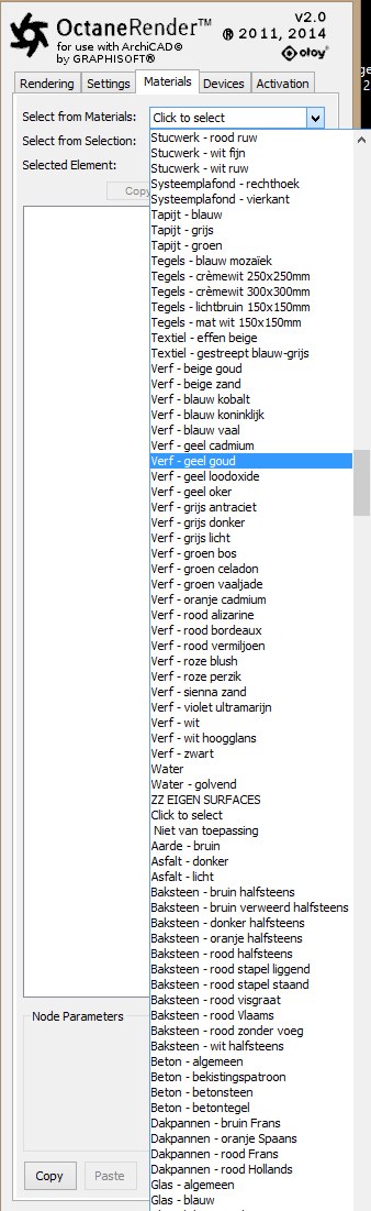

Hi Paul,
When doing a click to select for material,
then all materials are shown to select one form the list.
But the list is repeating itself about 6 times?
(this is not a v3 thing, but also previous version)
