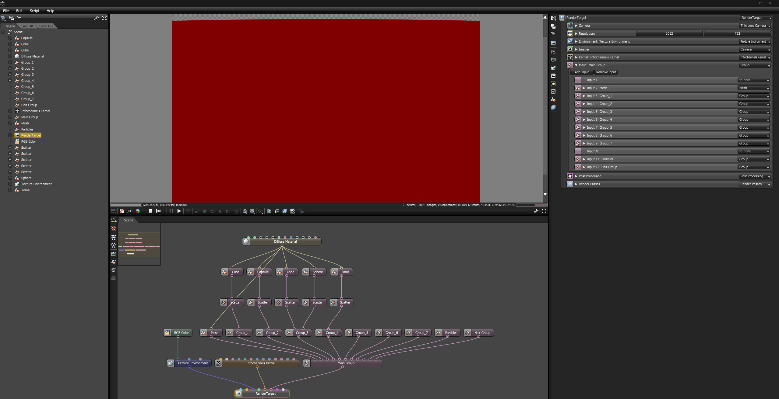

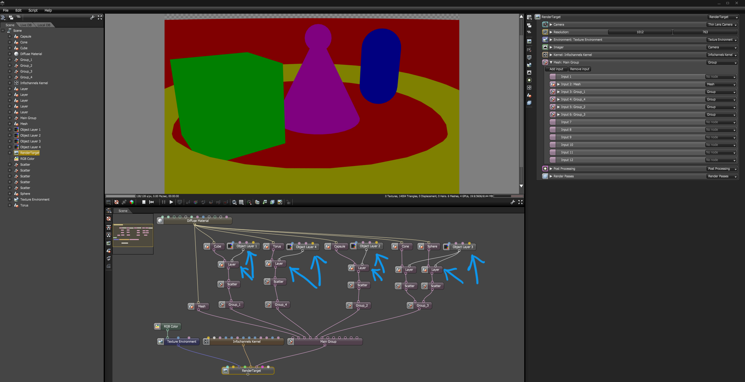

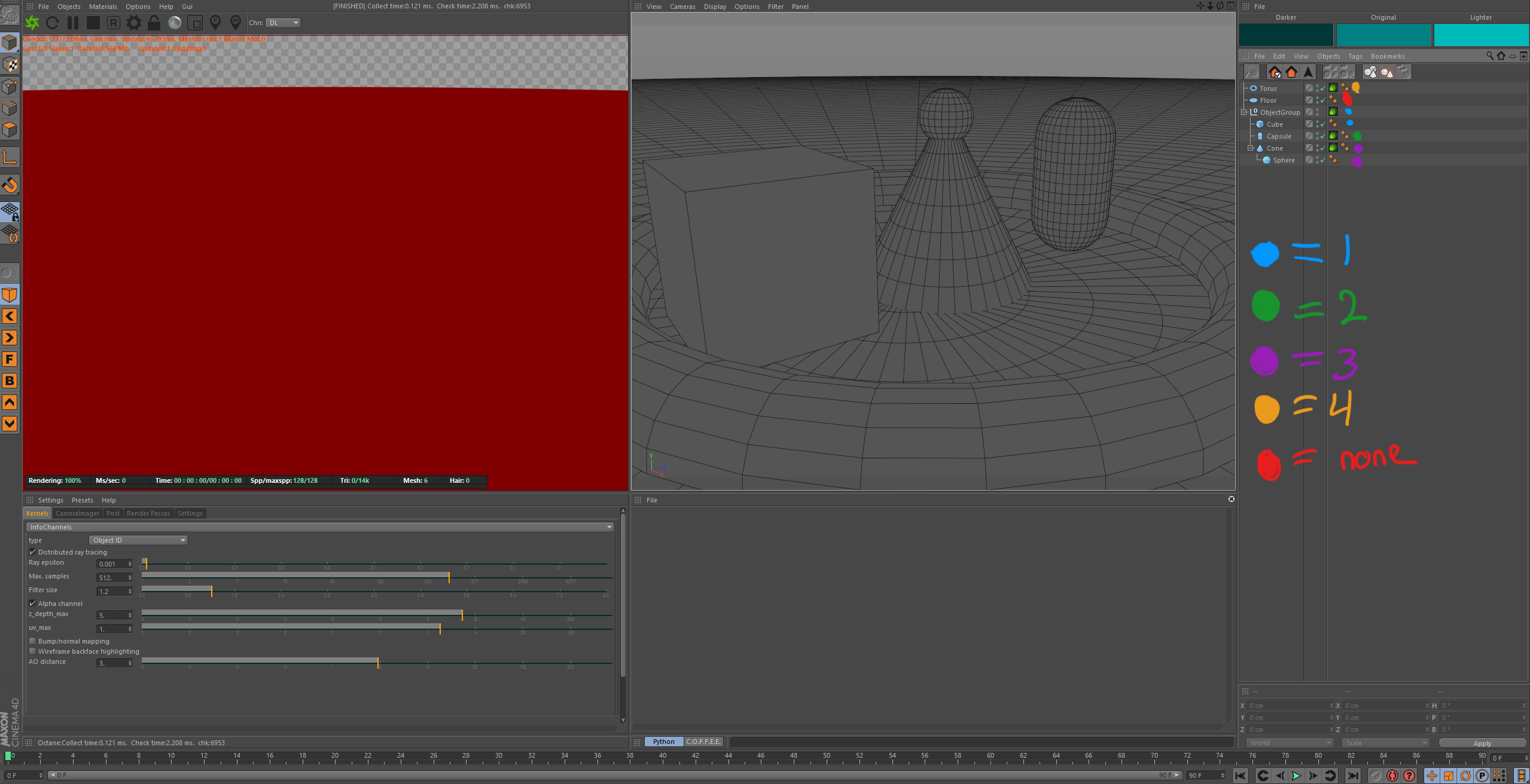

Hey Aoktar, I am having some issues with the Object tag and the object ID render. I have put together a few images to illustrate the issue. Put short it doesn't work.
Having tags on various objects seems to only sometimes work. I have attatched the test scene for you to look at. Each tag has a different mesh number and if I check Object ID it will just separate each individual mesh as a different color. What should happen is that the object and its children with the tag would be one color. and the mesh number should group all of the other object tag groups (with the same number) into the same color or layer.
What it looks like in cinema:
In Cinema
In Cinema
How Octane is seeing it using the edit in standalone.
How Octane sees it
How Octane sees it
And this is how it should look using the layers node.
How it should look
How it should look

"mesh no" is not for generating object ids. Only it distributes the objects different groups to provide better performance on plugin.
If meshes are connected to same "scatter" node, they can generate different colors. I think you are trying to get object ids, right?
If so wait a little until 2.20 and a better solution.
