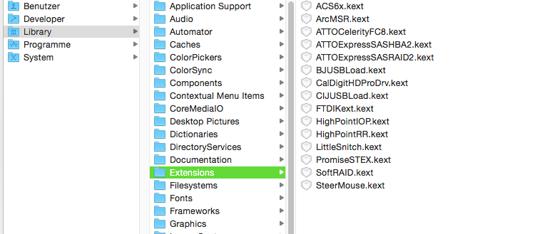

Are you in System or User Library? Can you show me full path!
Windows 10 Pro 64-bit / Intel Xeon E5 v3 @ 2.40GHz x 2 / 64 GB RAM / Z10PE-D8 WS / 3 x EVGA GTX 980Ti / C4D R17 / X-Particles 3.5 / Octane 3
skoeth
Posts: 67
Joined: Sat Sep 27, 2014 12:48 pm
it is the system library, the one that is not hidden
my HD/Library/Extensions
in the hidden (my HD/User/my Username/Library) library there isn't even the Extensions folder.

skoeth wrote:it is the system library, the one that is not hidden
You need to go to:
HD/System/Library/Extensions

oh dear, sorry for wasting your time - thanks a lot!

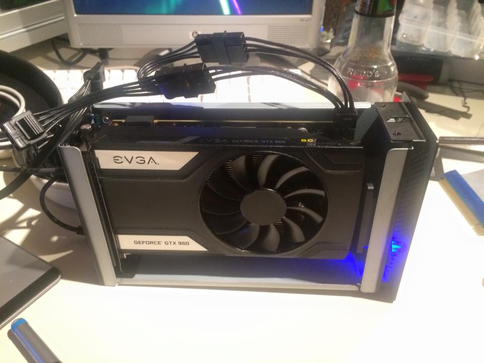

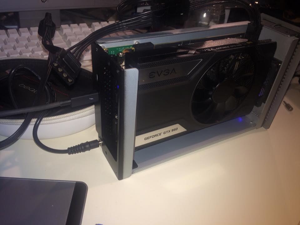

Group,
This is what I have
2014 Macbook Pro
AKiTIO thunder box 2
Corsair RM450
gpu EVGA Geforce GTX 960 SC
Has you see in the images like a glove.
I have read through the thread, could someone direct me to the simplest into getting this running. I am not a hobbiest, I use my Macbook Pro to make a living. I am doing this so when I don't have access to my render slaves I can still do some work and not rely on the nvidia gt 750 in my mac. It is slow for octane and it heats up my mac badly. I would rather heat the shit out of this 250 nvidia card, than my mac pro.
thank you for your input and direction
Allan
Windows Rig: Win 10 64, 64gb , 256 SSD, Stable OC i7 4.7Ghz Corsair water cooled, 1200 watt PSU, 3x MSI Seahawk GeForce GTX 1070 / amfeltec cluster x4 MSI Geforce 1080 Ti

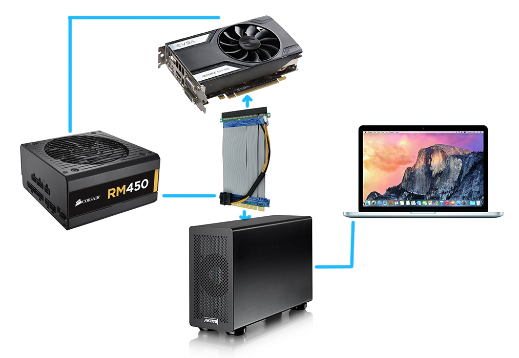

Parts:
-2014 Macbook Pro
-AKiTIO thunder box 2
-Corsair RM450
-gpu EVGA Geforce GTX 960 SC
Perfect...
Do not use the Akitio power supply.
Use:
-Raiser (http://www.ebay.com/itm/271448008328?_t ... rmvSB=true)
Tutorial:
https://www.youtube.com/embed/QfKb8TcHDkI
Works on 10.10.1, 10.10.2, 10.10.3
I have not test 10.10.4 but MarioVisuals did, and I think it works for him.

Why do I need a powered riser cable if I am already having the external PSU attached?
Jose wrote:Parts:
-2014 Macbook Pro
-Corsair RM450
Perfect...
Use:
Tutorial:
