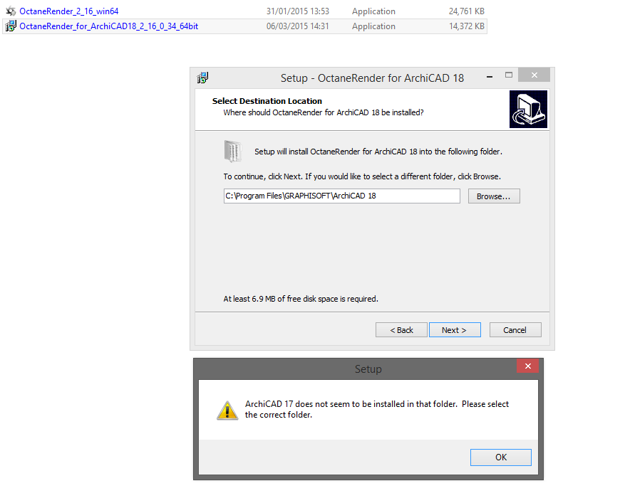

Hi there,
I am experiencing issue when installing The stable plugin onto the Archicad 18 Solo 3007.
Please see attached screenshot.
Zahi
Win10 Pro| ASUS X99-E WS| EVGA TITAN X OC| 32g Ram| i7 5820k 4.0GHz
face_off
Posts: 15756
Location: Adelaide, Australia
Hi. That error means that ArchiCAD.exe could not be found in C:\Program Files\GRAPHISOFT\ArchiCAD 18\. Do you have ArchiCAD installed somewhere else? If so, specify that location.
Paul
