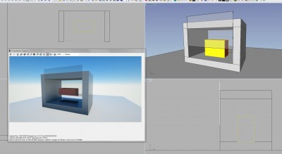

Hello Paul,
I was very happy when I read that the object based visibility option was fixed, however I found out that this does only seem to work as long as the objects are not behind other transparent objects like e.g. a glass plane.
I have attached a screenshot that illustrates the problem: the red object is supposed to be invisible but becomes visible when it is obstructed by the glass.
attached please also find the scene.
https://dl.dropboxusercontent.com/u/172 ... %20bug.3dm
I hope that it is possible to fix this bug in short time, since I really need this feature right now...
best
Andreas

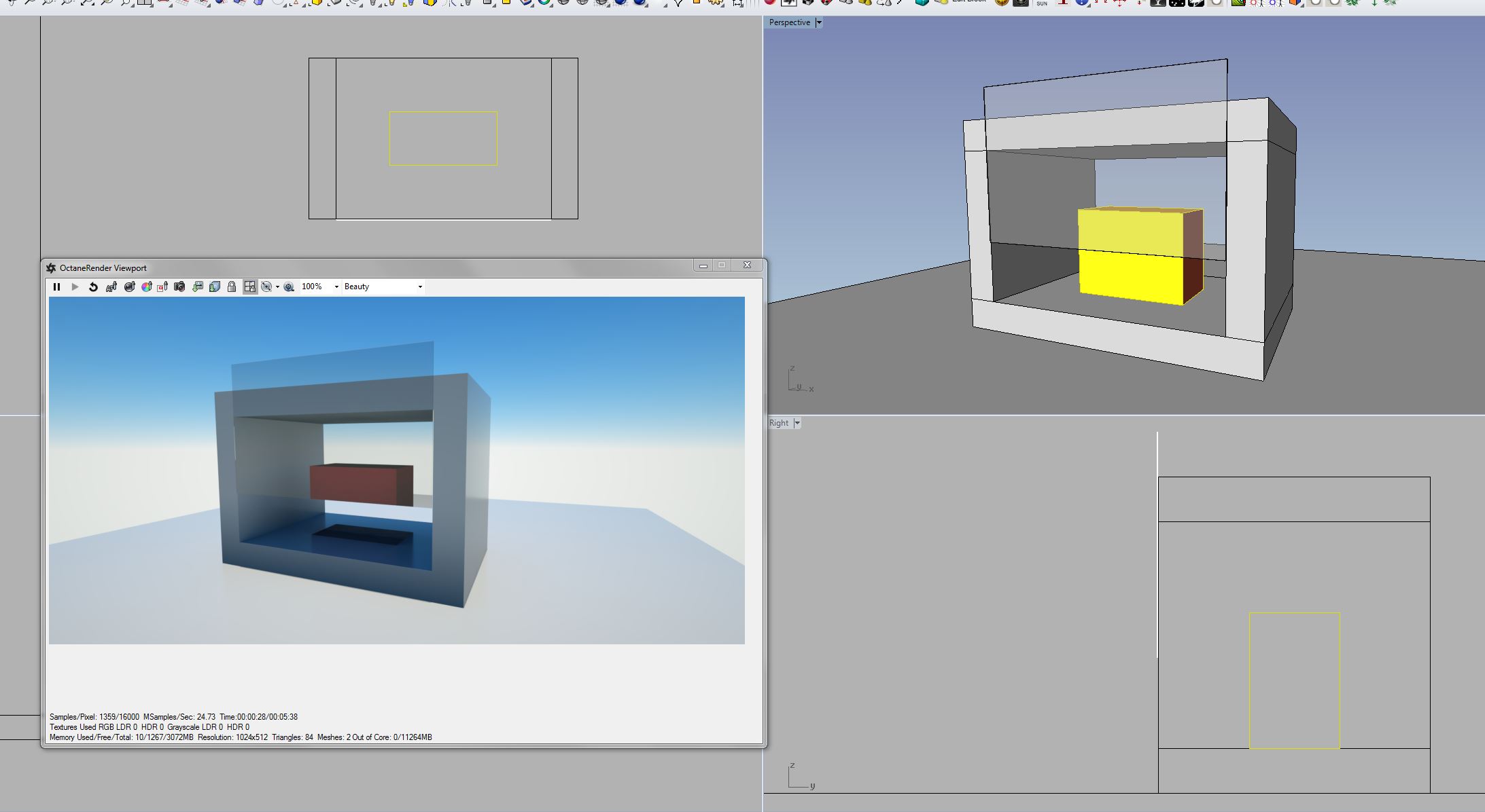

v-cube
Posts: 496
Joined: Fri Jul 22, 2011 11:02 am
Location: Basel, Switzerland
...similar thing: although the object is not visible, it is still being reflected and casts shadows...
best
Andreas
Architectural Rendering Services
1 x 4090 GTX, 1 x 3090 GTX
http://www.v-cube.de
face_off
Posts: 15825
Location: Adelaide, Australia
Hi Andreas - turning off object visibility does not remove the vertices from the scene - it just sets the opacity to 0. So try reducing the Kernel->Ray Epsilon. If that does not work, export to ORBX and post on the Octane Standalone test release thread so the Otoy devs can comment.

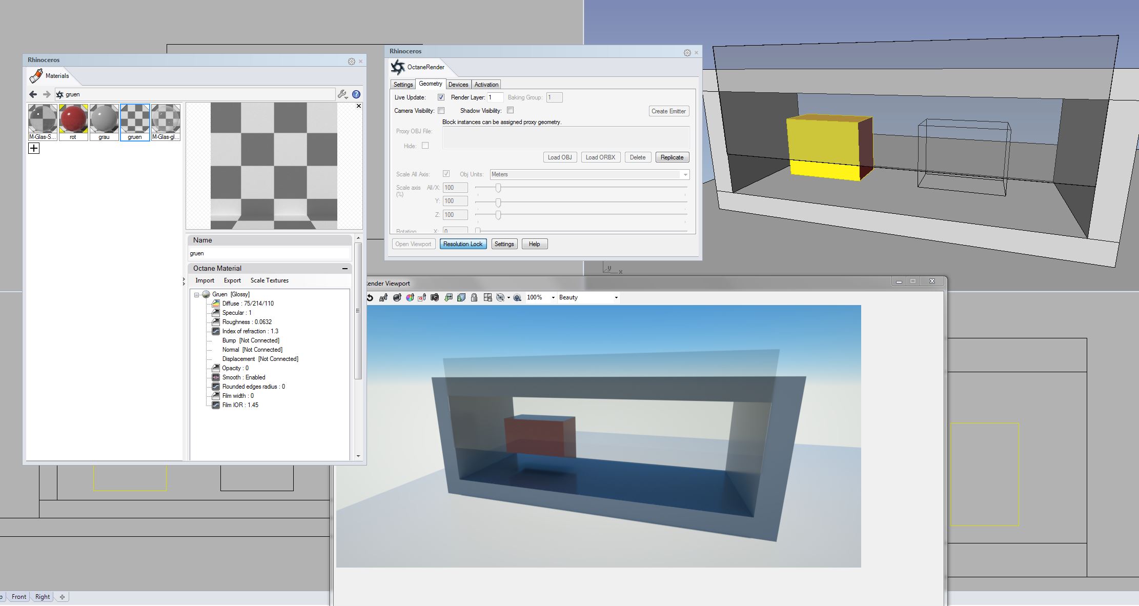

Hello Paul, I did a few more tests, tried out Ray epsilon and made another box with a green material on it the materials opacity was set to 0.
As I expected changing ray epsilon did nothing, also the material with the 0 opacity does not show any bugs.
I also did an orbx export and the bug also shows up in octane standalone.
I will do another test with octane 3 beta and then post in the release thread as you suggested.

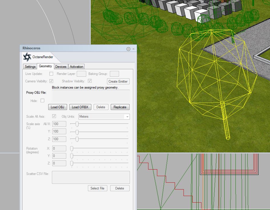

Hello Paul,
I found that the "hide" feature with proxies attached to blocks does not seem to work sometimes.
I attached a zip file with a rhino file and a orbx file to illustrate the problem.
when I check the "hide" checkbox , deselect the block and then reselect it again the check is gone.
can you repeat this ?
Yes, both Hide and the Scale/Rot From Block Instance checkboxes are not being saved. This will be fixed in the next release.
