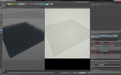

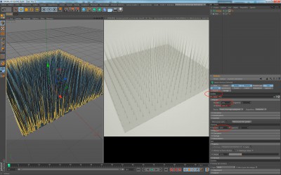

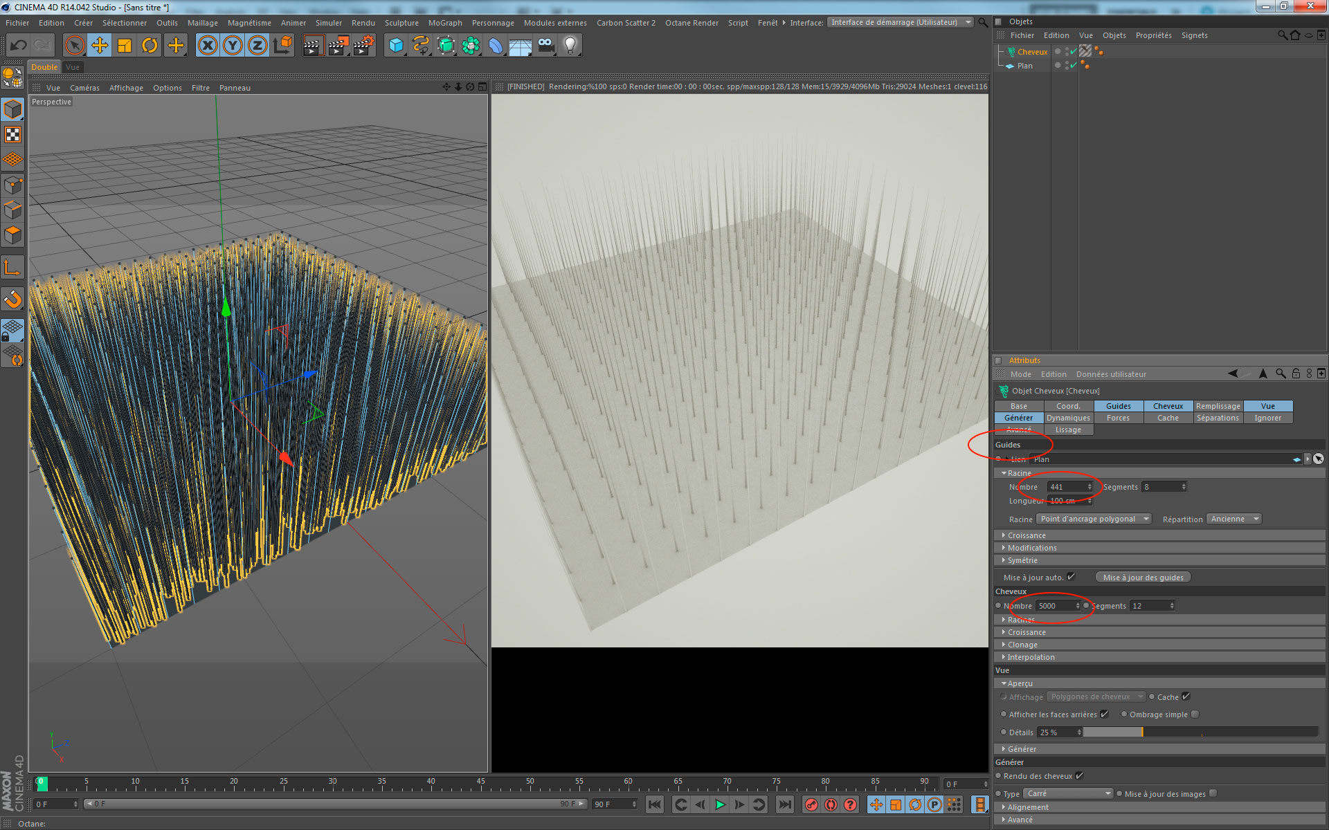

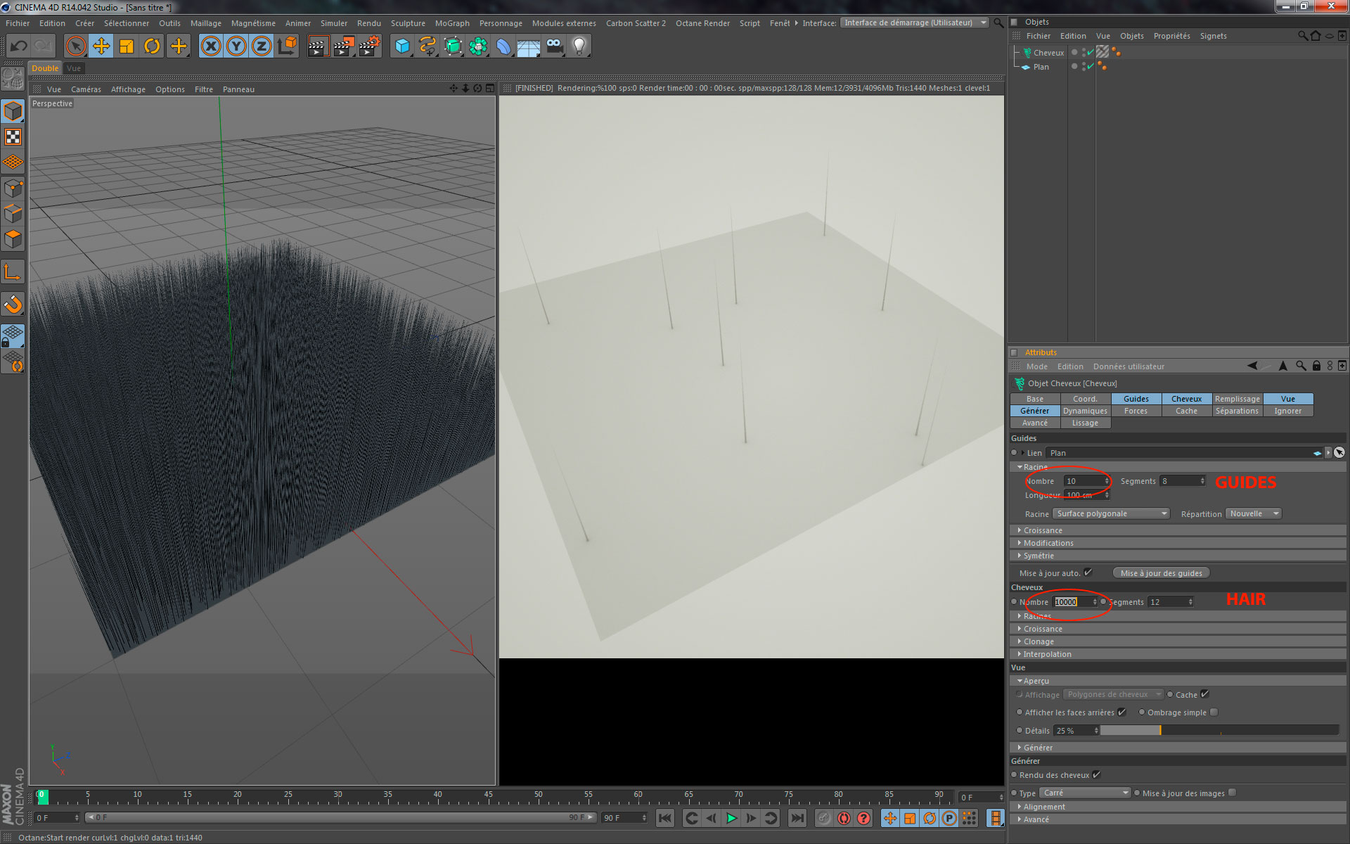

I've found another issue with Hair.
The plugin is able to render Hair (as polygonal) since the first version i think but now it render only the number of guides, not the number of hair. I'm almost sure it wasn't the case before. Hope this wil help you.
EDIT : I work with C4D R14.
Hair = 10000 / Guides = 10
Hair = 5000 / Guides = 441
