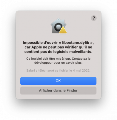

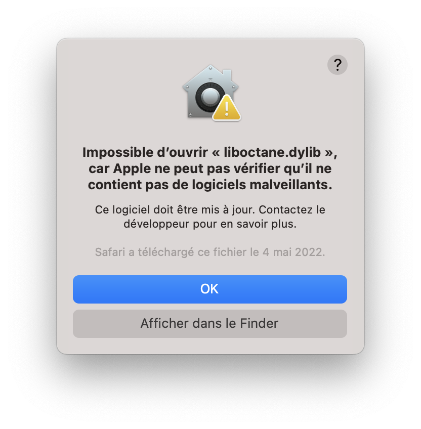

This morning I get an error message from apple/OS X Monterey, 12.4, blocking Octane (and Forester Plugin too)
Updated OS to 12.5 but problem persist.
It was working Friday.
Usually when apple block a software I can go to security to allow the software, but this time I didn't find anything since it's not a dot app but a library.
Any clue on what to do ?
Attaching a screengrab, in French, it says something like:
"impossible to open "liboctane.dylib" because apple cannot verify blah blah, this software must be updated. Contact the developer to know more."
Thank you

OK solved, you can delete the messages. It is possible to unlock the dylib if manual opening them in finder.

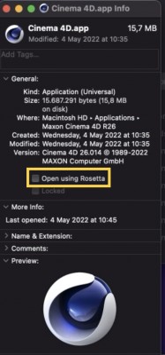

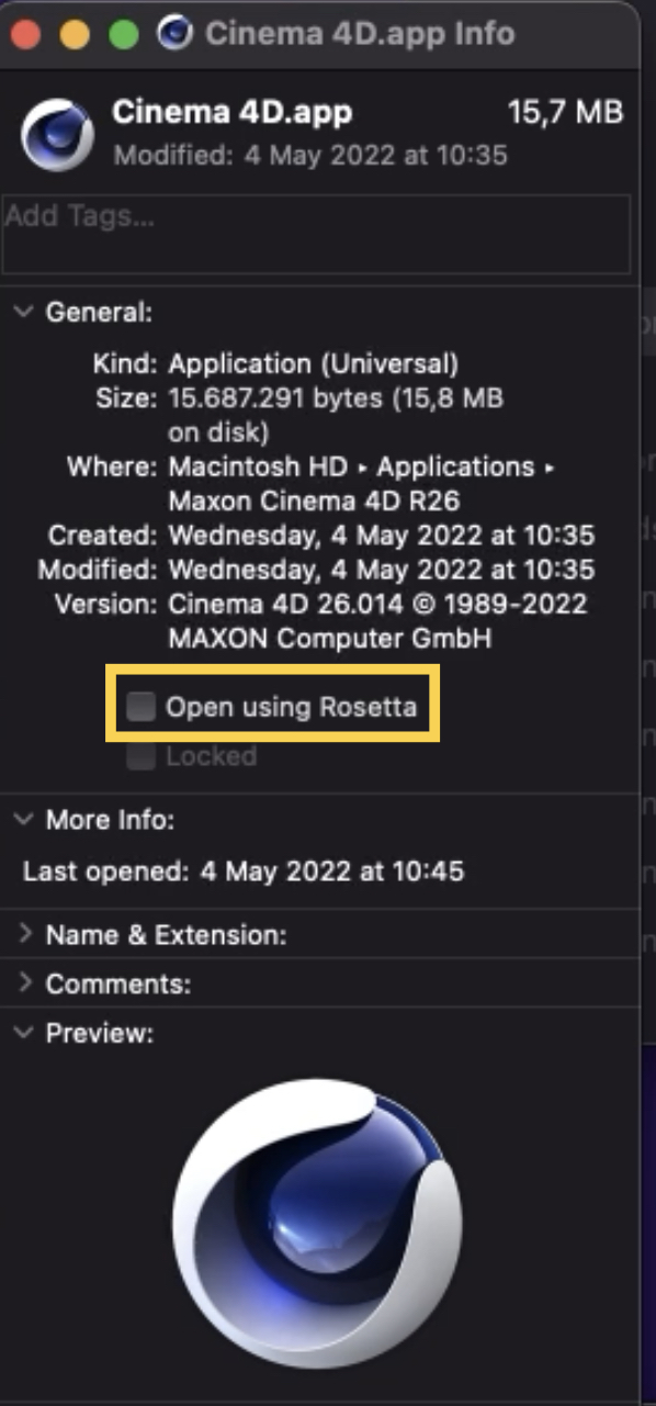

Remember to disable the Open using Rosetta option in the Info of the Cinema 4D.app:

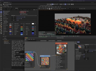

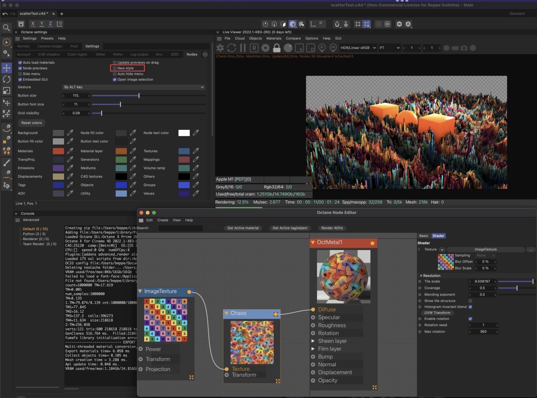

Finally, you need to go to c4doctane Setting/Nodes, and disable the New style option, or material preview doesn't work in node editor:
