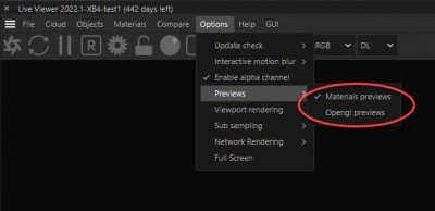

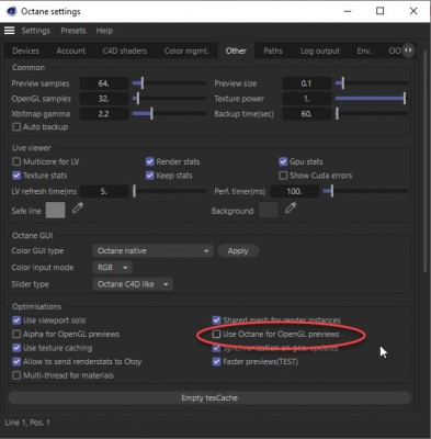

What has helped a ton, is turning off material previews both in node editor and in scene.
