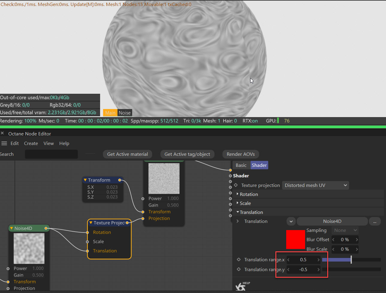

protokol wrote:I believe the Distorted Mesh UV projection has been broken since R3.
I open the same file with R2 and the material works
It looks like working. Can you send a sample to show what's not working for your opinion?
I have attached the file. It works with R2 but fails with R3-5.
Cinema 4d_Distorted Noise_Test_.rar
(102.01 KiB) Downloaded 204 times
Posts: 16068
Location: Türkiye
protokol wrote:
It was broken for previous builds because of some default value problems on parameters. In R2 that seems considering that translate=(0.5,-0.5). You can get same results by changing it as in picture for R4.
protokol
Posts: 44
Joined: Mon Aug 24, 2015 8:16 am
It was broken for previous builds because of some default value problems on parameters. In R2 that seems considering that translate=(0.5,-0.5). You can get same results by changing it as in picture for R4.[/quote]
Thanks for the quick reply, much appreciated!

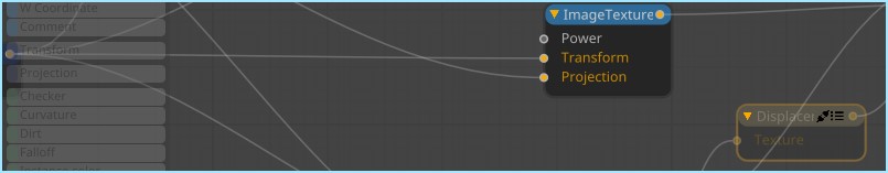

Disabling Displacement node makes Node menu transparent :
Architectural Visualizations http://www.archviz-4d.studio
Posts: 16068
Location: Türkiye
SSmolak wrote:Disabling Displacement node makes Node menu transparent :
I know it and fixed currently. But thanks for your helps.
