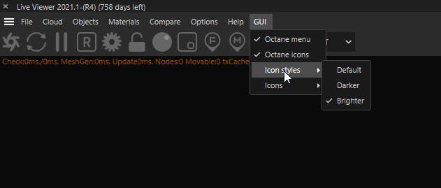

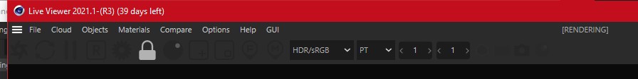

Hi, Aoktar
Please do something with the contrast of the liveview window tool icons in R25. It is very annoying and unpleasant the way it is now. Sometimes can't even tell if geometry, lights,... updates are active or not.

Kalua wrote:Hi, Aoktar
Regards,
I did, LV/GUI/Icon styles/lighter
Regards,
Thanks al lot! I didn't realize we had that now.
The right side icons (geometry, lights, camera and materials update) are not affected by these contrast values right? Would be great if they were.

Kalua wrote:
Regards,
Regards,
Yes but for next time, you can modify them if you wish also.
