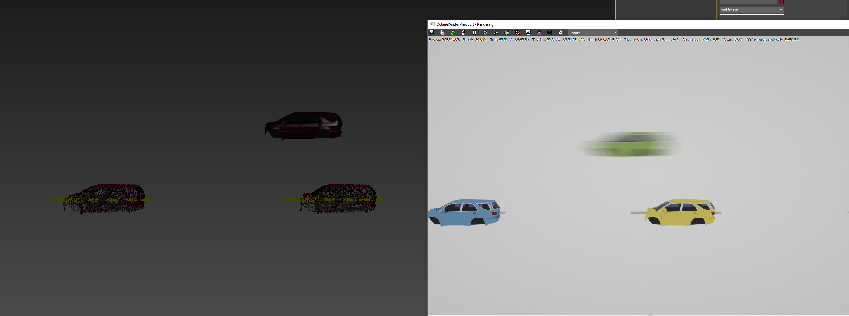

coilbook
Posts: 3145
Hi I attached the scene with itoo motion blur bug. Regular mesh has it. Itoo objects don't. I hope you can get it fixed. Itoo saves us so much time when working with thousands of objects. Thank you
itoo mb bug.zip
(1.62 MiB) Downloaded 246 times
