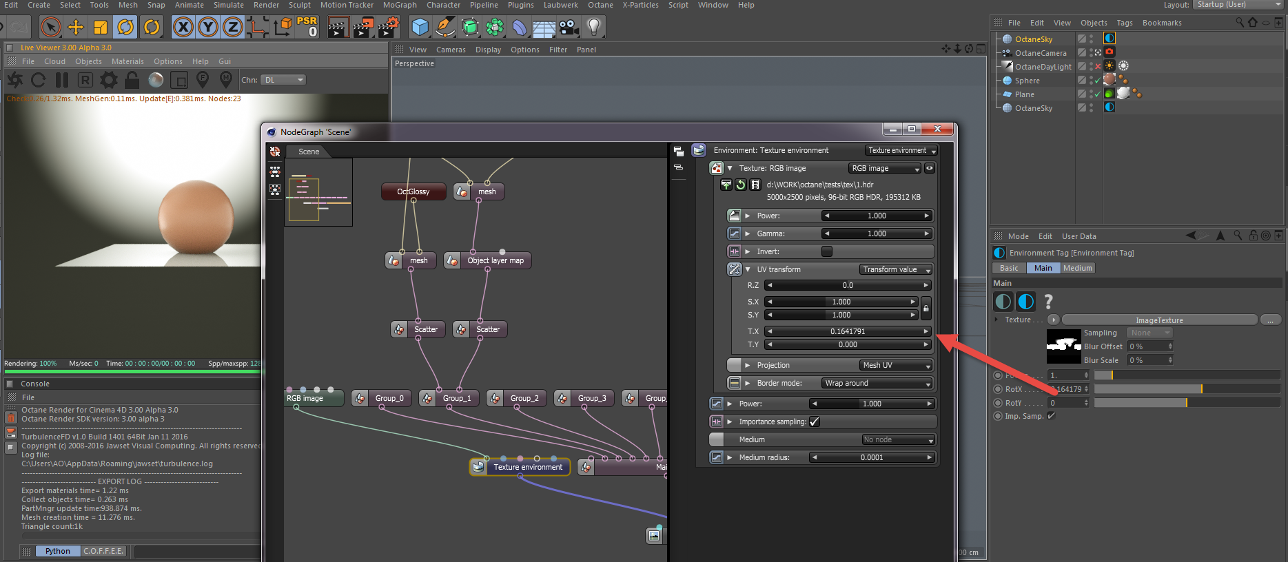

Dinf,
Check the slider result from LV->Help->Show Octane Nodegraph as in image. Both values should be same.

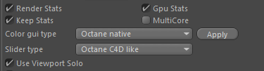

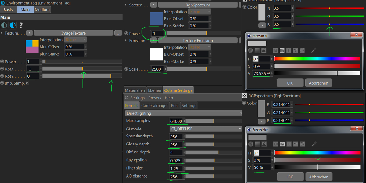

aoktar wrote:Dinf,
A Nodegraph Scene View? Oh, wow, since when? Great!
What do I have to do to get the scene visible in the Nodegraph?
However, don't get me wrong: the values are ok. The slider positions aren't. The middle position is a 1/4 value of the biggest value. If this is 1.0, the middle position shows 0.25.
This is mostely a cosmetic thing but in some cases irritating. Have a look at the RotX and RotY sliders for an environment texture wich goes -1 from the middle to 1 on the right. Same for the phase slider wich is also a -1.0 to 1.0 slider. The only exception I found so far is the Diffuse Depth in the Kernels, wich does neither show the half (4 of 8) nor the 1/4 (2). And the RGB values behave a bit strange in connection with the color picker.
Look at the green underlined.
As said, mostly cosmetique stuff (to me).

Dinf,
Didn't aware this. I think that's a problem with C4D sliders. Switch back to Octane types.
