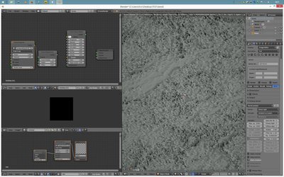

EricSerpi
Posts: 8
Joined: Fri Aug 10, 2012 7:59 am
Phantom107 you need to unwrap UV first ;)
EricSerpi
Posts: 8
For me it's like that with a 8k texture... seems to be in 256x256... and level of details don't work
Phantom107
Posts: 686
Joined: Tue Jul 24, 2012 11:31 am
Location: The Netherlands
I am doing architectural rendering, and I am using the 'Octane Box Projection' node to create the UVW for me essentially... in 99% of the cases this works very well. So I guess I need an actual UV map instead of a Box Projection by Octane? Cause without displacement it's working just fine. :roll:
