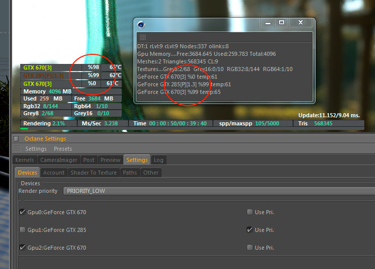

First thanks a lot for this great plug-in ! :)
I have also found a little bug. Not very important.
As you can see in the capture, the HUD indicate my GTX285 is working with only one GTX670. Only my two GTX670 are working. I'm sure this is the case because I've tested with 285 and the performances change radically.
I work with one GTX285 inside my computer and two GTX670 inside a Cubix Xpander connected to the second PCI Express port of my computer. In Octane standalone, my GPUs are correctly recognized.
I hope this will help you ;)
