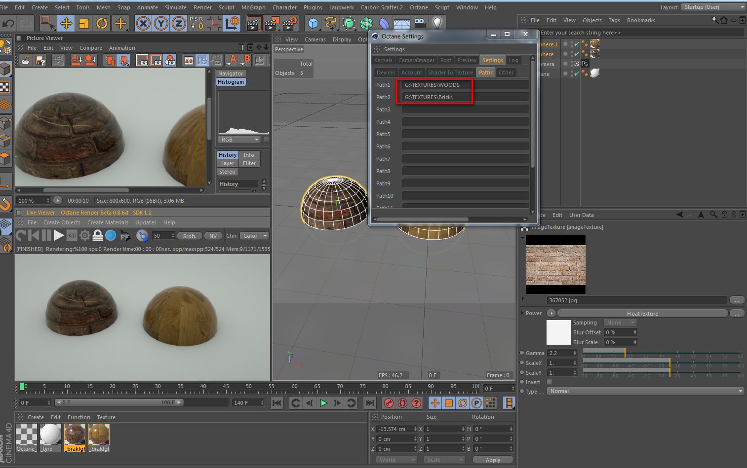

Posts: 16068
Location: Türkiye
Hi Rudi,
i checked your scene but did'nt understood. Your paths is relative, where is your textures? is in paths which are setted in texture paths?
check my picture.
Rudi
Posts: 188
Joined: Sun Sep 01, 2013 7:05 pm
This description I have the problem again:
http://render.OTOY.com/forum/viewtopic.php?f=30 & t = 35459
I do not know whether you have read it already?
The path is used eg
D:\Textur\c4d
The texture is in fact under
D:\Textur\c4d\plant\baum\Textur-A
And under
D:\Textur\c4d\plant\Strauch\Textur-B
I put the path directly, just like you in your example, everything is alright.
But octane render must read but the subdirectories and memorize. You can not always adjust the paths... :roll:
opic.php?f=30&t=35459
