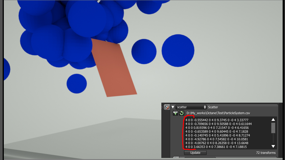

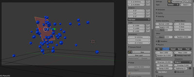

Guys, need your help. :? I had made something wrong, but don't understand what exactly. Size and placement of particles in Blender and in Octane do not match. Matrices have been exported with a scale 4, but, as you can see, I use velocuty normal 1 and don't use any random parametrs.
Sorry for my English. :oops:

@Saramary, the Rotation panel (checkbox) in Blender must be enabled. So when you tweak your PS, first enable that. See the first page for guidelines what you can & cant do :)
(in the case that its still not working, then post the .blend)

:( Still doesn't work.

@Saramary, I looked at your scene but cant find what is wrong. It may be something with the exporter, not your settings (I did most of my testing on hair PS, not emitters).
I would need to do a more thorough analysis of the exporting process in case of emitters. But I cant promise when, because I have other stuff going on right now. I'll contact you as soon as I make any progress.
