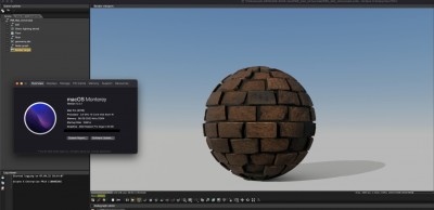

@rasmusb: AI Denoiser is working with no issues here, with OctaneX PR14 and AMD GPUs/Intel CPU, under macOS 12.3.1:
