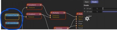

Octane freeze immediately using UV coordinate node in this setup :
and just after when something in UV is changed.
Really there is no chance to disable this auto sub-sampling switching after some seconds of lag ?
Architectural Visualizations http://www.archviz-4d.studio
