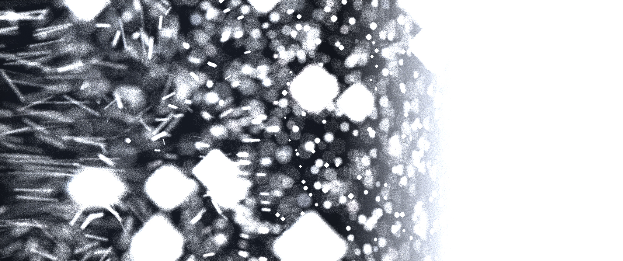

Dear community.
Im handling multi-layered EXR files (32 Bit/Channel) and I am wondering, why my depth pass looks like the attached image. No matter what value I set "Z-Depth max" to (What are the units for "Z-Depth max" anyhow?) the result remains the same: An image with almost zero grey values - basically everything white.
I use EXtractoR in AE to extract the passes...
Could it be, that the z-depth pass is not supplosed to be saved into an multi layered EXR file?
Best.
Moritz
Best.
Moritz
