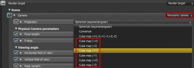

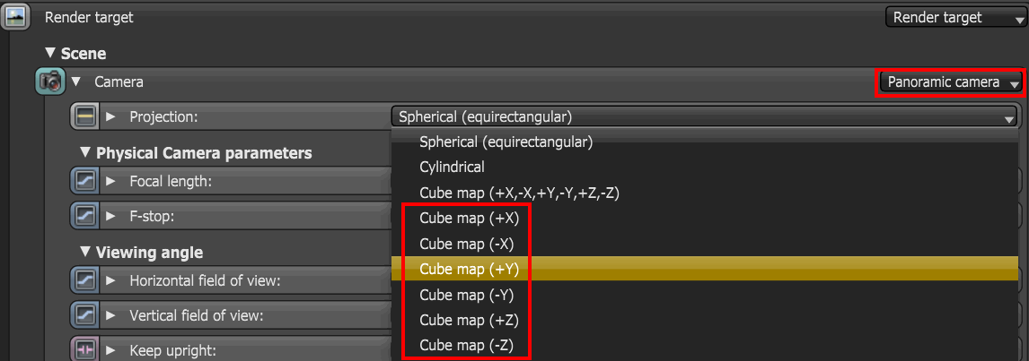

Panorama Rendering - Individual axis option needs
I am planning to render with Cube Map(panorama).
It is not for the VR Device(HMD).
Final rendering should be very high resolution. And I only need 3 of 6 sides.
Rendering 6 sides takes too long time.
However, my scene has a large number of generators, making it difficult to output orbx.
Standalone Camera has an X + X -... options.
Could you add individual X + X -... in Cube Map?
